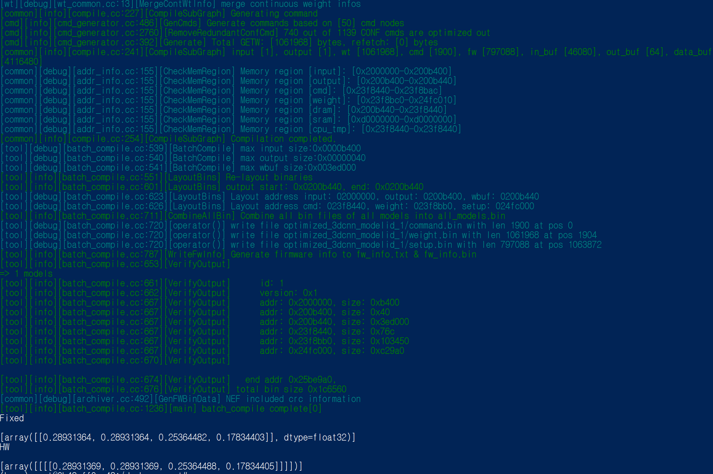

I converted 3DCNN - video classificatin model to nef as follows:

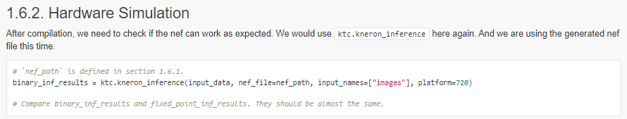

  • Thanks a lot Nick for answer.
    I already simulated tool chain docker with kl630 with following code
    which Corresponds to 1.4~1.6.2. Hardware Simulation step.
    The result of the above code is
    Above results shows binary_inf_results is almost same as fixed_point_inf_results.
    Please give me advice on what I can do next.
  • Hi Youngjun,
    Your binary_inf_results and fixed_point_inf_results should be almost the same, so it seems successful.
    According to your screenshot, it seems like your nef file is generated. It depends on where you set the nef path, but it is usually in /data1 folder.
