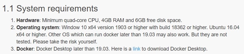

If you use Vmware , try add CPU and RAM to setting
I am using Docker version 20.10.7, build 20.10.7-0ubuntu1~18.04.1
How to fix the issue for docker??
