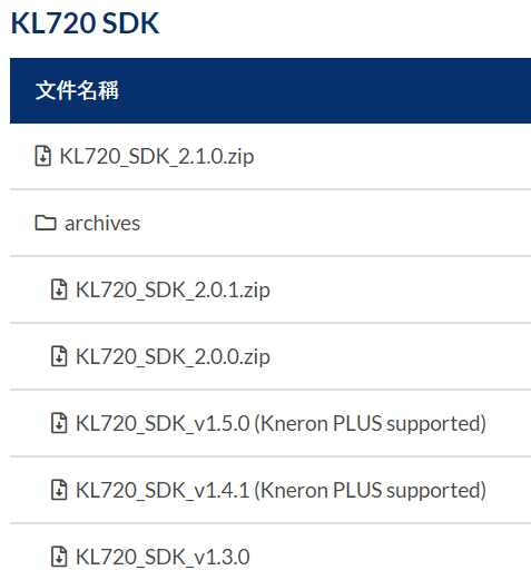

You can build the Kneron PLUS 1.3 firmware for KL720 in the development center under "KL720 SDK":
Kneron PLUS 1.3.0 is compatible with KL720 SDK v1.5.0, and with KL520 SDK v1.7.0.

Yes, for KL720 SDK v1.5.0, the KL720 SDK contains the project inside firmware/build/solution (any of them)/sn72096_9x9, in .uvmpw format, which serves as a workspace that can access other linked .uvprojx projects.
However, editing NCPU isn't supported in KL720 SDK v1.5.0, so I would recommend you to use the updated KL720 SDK v2.1.0 (compatible with Kneron PLUS version v2.1.0), and the NCPU folder would be in firmware/platform/kl720/ncpu. Also, you'll need an Xtensa Xplorer license to edit the KL720 NCPU.
