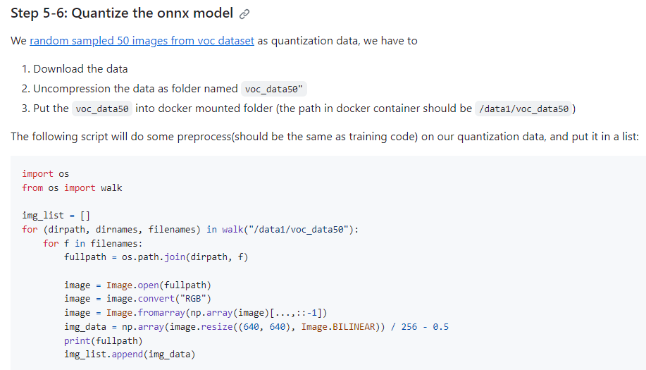

When you quantize the onnx model, you would go through a script where you do some preprocessing on the image data:
In the image above, it says
And that is where you do the normalization.

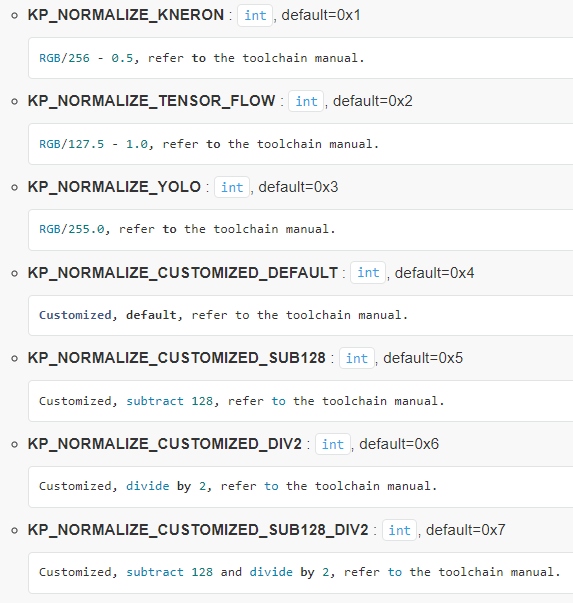

According to the list above, the preprocessing goes through a Kneron normalization because it does RGB/256 - 0.5
So you could check your script to see what normalization you're doing.

If I use TensorFlow's normalization, what should be the data range after conversion?
If my model learned the normalization of TensorFlow and compiled into the nef model, is the data range of the nef model also the same as the normalization data range of TensorFlow?
If correct, I think the normalization range is wrong when I compile to nef model, but I want to check the normalization of nef model.
Hi Hyun,
When you say "use TensorFlow's normalization," did you mean the deep learning framework, or KP_NORMALIZE_TENSOR_FLOW in the image in the previous reply? The data range depends on your normalization, and for batch normalization in TensorFlow, there isn't an exact data range, since it depends on its parameters. Usually, the data range after compilation is the data range you chose, such as [0, 1] or [-1, 1].

Yes, KP_NORMAZE_TENSOR_FLOW is used for compilation, and the data range after compilation is not [0,1] or [-1,1].
If I dump the pre-processed input data, the it min/max value is [-8,3].
I think it's wrong.

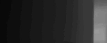

Refer to my inference server (onnx) and toolchain (nef).
This image is a flat wall.
(input rgb)
(server's inference result)
(nef model's inference result)
nef model reasoning looks like a staircase.
So I think normalization or quantaization is wrong.

This depends on your normalization used on your preprocessing. You could change your normalization according to your trained model and application.
Additional information: For Kneron NPU structure, it's better to have data normalization that fits -2^x~2^x-type of input data
Since nef models went through quantization and float -> int conversion, the results wouldn't be exactly the same. If you got the [-8, 3] range from NPU dump, then that would be the input after quantization, which wouldn't be [-1, 1] anymore.
