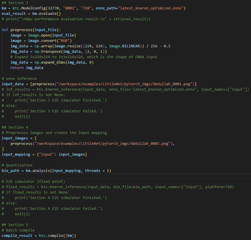

The code used for the conversion of bie to nef is as follows:

    Sorry for the late reply. The error message "Input onnx is missing" means that your input is missing the onnx file. Please make sure you're including an onnx file as an input.
    Thank you for providing the onnx files. This might not be a compiler issue, since I assumed that your toolchain generated bie file properly, but I didn't see any bie files attached, and when we tried to convert the model to nef file, the nef file did generate.
    The sample code above has a random image for input_images. Please feel free to use more images to keep the model accuracy.
