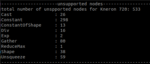

I am getting above error while converting from onnx to nef format. There are few unsupported nodes as shown below. (But another model also has these nodes, but it successfully compiles for nef). How can i fix this?
I have attached error log, inference code

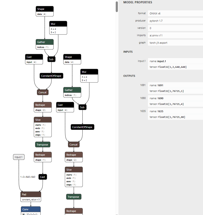

and screenshot for nodes present in the model. Some operators are not supported on the hardware, but is there any way to replace them as they cannot be deleted.

    The onnx model you've attached (effdet_kneron_ops.onnx) seems like it hasn't been optimized yet:
    You will need to optimize the model with onnx2onnx: 3. Floating-Point Model Preparation - Document Center (kneron.com)
    After that, if it still doesn't work, you can also try cutting unsupported nodes by using model editor:
    ONNX Converter - Document Center (kneron.com)
    And you can manually add them in your postprocessing code to replace the ones cut out from your model.

    Our model team checked your script, and it looks okay.
    Before converting your model, we would suggest you to follow these steps:
    1. Use onnx-simplifier to simplify your original onnx model (Note: not the optimized one)
    2. Run onnx2onnx
    3. Since there are nodes that aren't supported by KL720 (such as ReduceMax, Gather, Exp, etc.), you could use model editor (editor.py) to cut off all the nodes after Transpose (including Transpose too). You could cut them off, then add back the nodes that were cut off in your post process function. Either that, or you could come up with a way to change these nodes to nodes that are supported by KL720
    After going through these steps, your onnx file could be converted to nef file by running your script.
