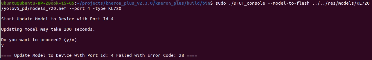

May I know how to upgrade the KL720 usb dongle? I have followed the instructions inside the documentation but always failed with error code 28. Please advice.

No, I am not running on virtual machine. I have tried running in both ubuntu 18.04 in docker container using KneronDFUT.sh and ubuntu 20.04 natively using DFUT_console. Both cases have the same error.

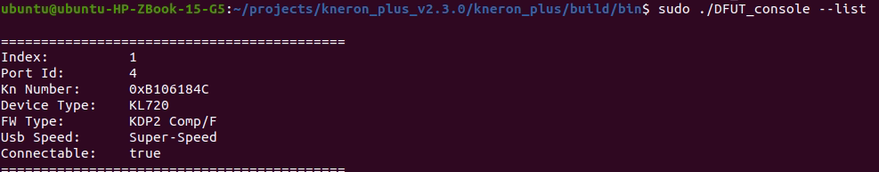

I also suspected if the device has been upgraded before since the FW type is showing "KDP2 Comp/F". So then, i also have tried to flash in the model, still the same failure happened.
When your KL720 dongle has FW Type KDP2 Comp/F, you should be able to run Kneron PLUS examples such as kl720_demo_generic_image_inference.
