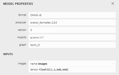

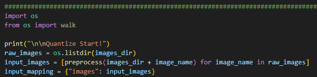

    According to the optimized onnx model, it seems like the correct input name for the onnx model is "images"
    Please change the "input" into "images"

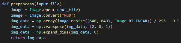

    We also recommend you to write the preprocess function:
    And process the images with the function:
