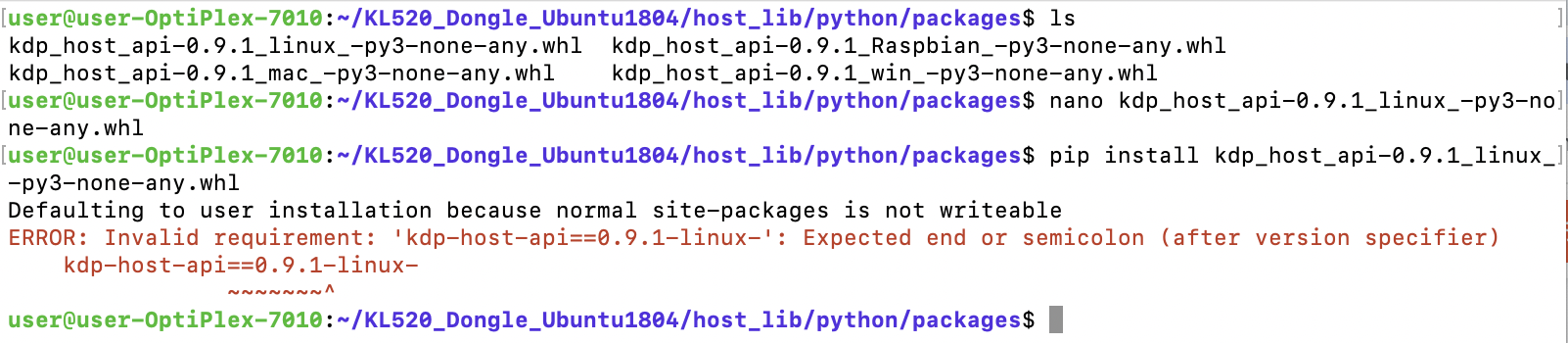

    I was trying to set up the environment for the KL520 example. However, it occurs some errors as below,
    I'm not sure whether the error is related to the Ubuntu version. Mine is 22.04. Or just a syntax error? I was following the instructions from the Internet and stuck on the kdp-host-api things...
  • Hi FK,
    It appears that you are using an outdated version (host_lib) that is no longer supported. Please uninstall the previous version and install the latest one.
    The new development tool is PLUS. You can download it from the following link:
    https://www.kneron.com/en/support/developers/
    You can find the corresponding files in the directory: /kneron_plus/python/package/.

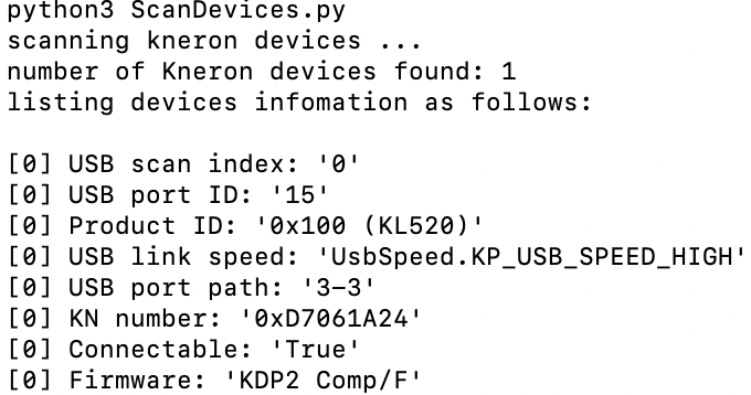

    This is the result from ScanDevices.py.

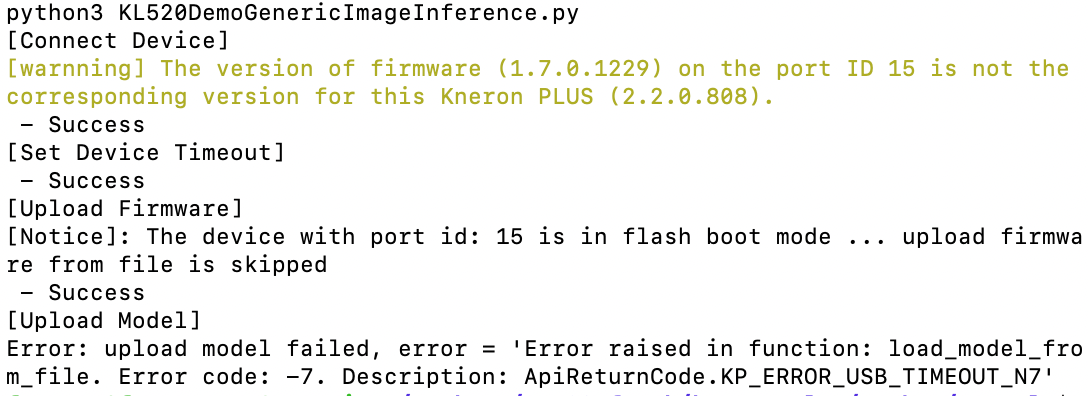

    I was trying to run the sample codes from the Document Center. However, I got the "upload model failed". Did I miss anything regarding the model build-up?
    My kneron version is from kneron_plus_v3.0.0.zip.
    or should I upgrade the firmware? and how? regarding the "warnning"

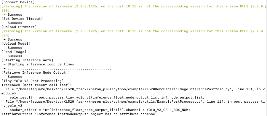

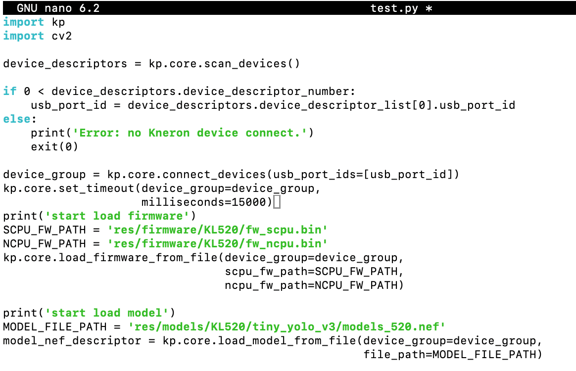

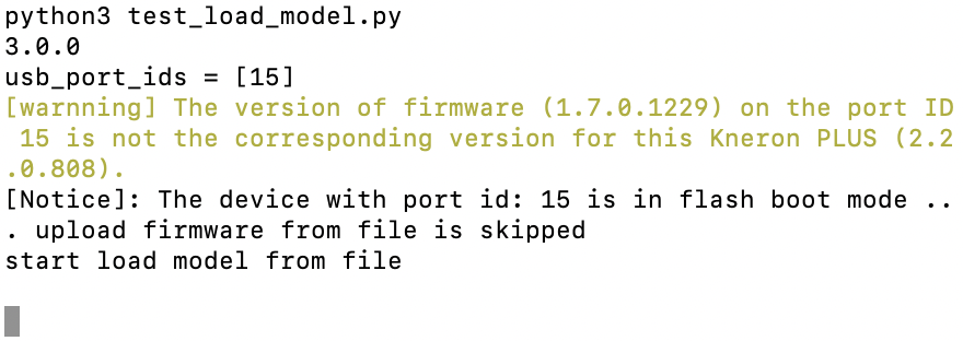

    I found it may be the lack of model upload. However, I recheck the model uploading process. I got the message from my code:
    My code:
    and it seems stuck on the "kp.core.load_model_from_file()" see below,
    Not sure whether the "warning" needed to be concerned?
  • Hi FK,
    If you are using KL520 dongle on Kneron PLUS, please make sure that:
    -These dependencies are installed: Install Dependency - Document Center (kneron.com)
    -In regards to the warning, we would recommend you to use the same version for your firmware in KL520 dongle and for your Kneron PLUS (e.g. both use version 1.7, or both are using version 2.2)
    For now, in the log, it says that the KL520 dongle is using flash boot mode (firmware 1.7.0). You could update your dongle to USB boot and try running it again.

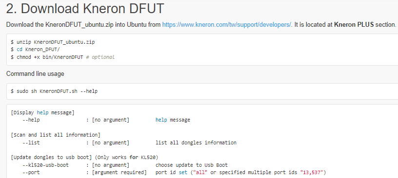

    To update your dongle, you could either download Kneron DFUT (Developers | Kneron – Full Stack Edge AI), or if your Ubuntu isn't Ubuntu 18.04 (x86_64 64-bit), you could also use DFUT console provided inside Kneron PLUS and use the commands to update.
    Information on Kneron DFUT: Upgrade AI Device To KDP2 - Document Center (kneron.com)
    Build DFUT console in Kneron PLUS: Build Kneron PLUS - Document Center

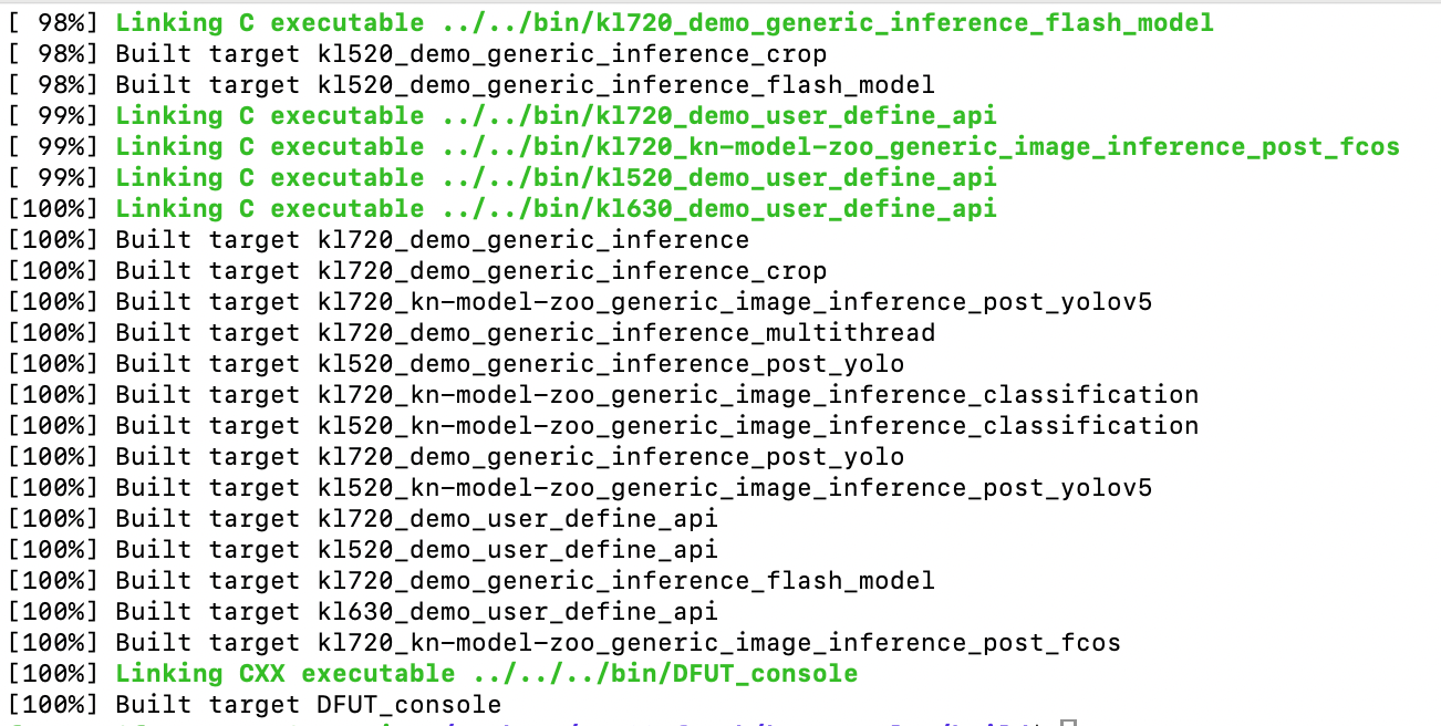

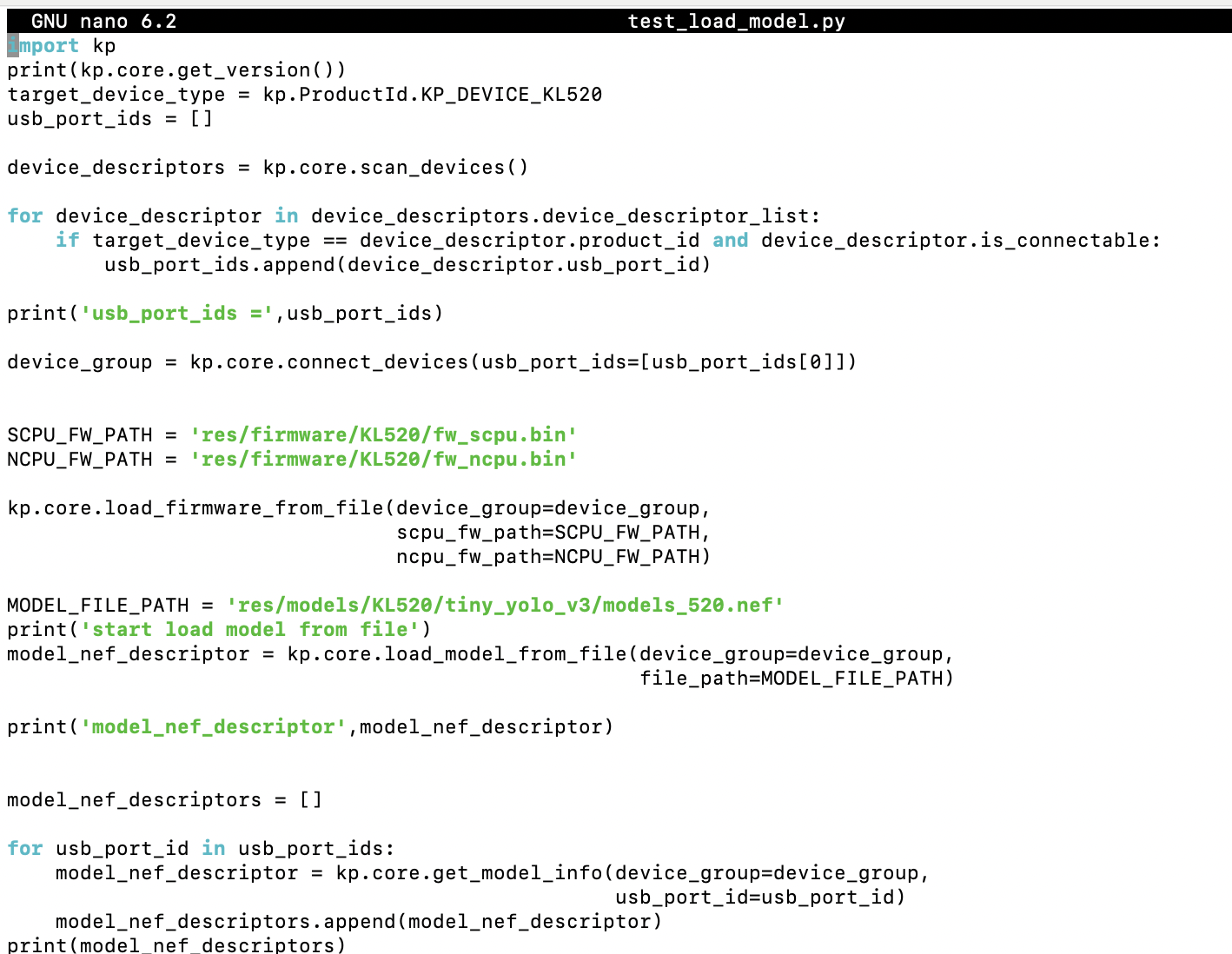

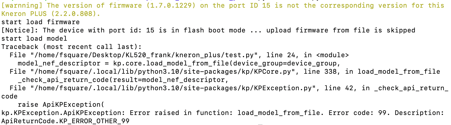

  • I followed the instruction for DFUT console building by https://doc.kneron.com/docs/#plus_c/introduction/build_plus/#23-build-with-dfutconsole
    This is my code and I tried it again,
    However, got the same result......(I set the timeout this time in case forever stuck)
    The suggestion from the post,
    How can I upgrade my dongle?
  • Hi FK,
    The log is showing that you are still using flash boot mode, so you would need to either:
    -Update dongle to USB boot, then the Python program would load from SCPU_FW_PATH and NCPU_FW_PATH when you run the program, or
    -Update dongle to flash boot with the firmware inside kneron_plus/res/firmware/KL520 folder.
    You can refer to the section "Upgrade AI Device To KDP2" inside the document center: Upgrade AI Device To KDP2 - Document Center (kneron.com)
    To update your KL520 dongle to USB boot, please go inside kneron_plus/build/bin and run ./DFUT_console and use --kl520-usb-boot and specify your --port, as shown in the image above.
  • Hi Maria,
    Thanks for the help. I've updated my KL520 dongle to USB boot. Thanks a lot.

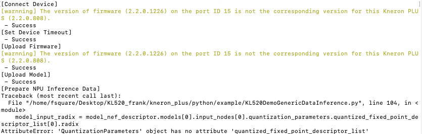

    The code "KL520DemoGenericImageInference.py" I ran is totally fine. However, I was trying to run the python code "KL520DemoGenericImageInferencePostYolo.py". It occurs some errors as below,
    I found the errors that I got from some examples also happening the same things "no attribute channel" . I think the problem is from the post-processing?
    Also another attribute error is from "KL520DemoGenericDataInference.py"
    Did I miss any processes like installation? I was trying to firstly make sure the overall codes and environments are fine and then dig into further application.
    Please give me some clues. Appreciate it!

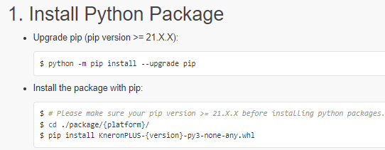

  • Hi FK,
    Have you installed the Python package? Please go to kneron_plus/python/package/[your environment], and pip install the .whl and try running the python examples again.
    Dependencies for Python: Install Dependency - Document Center (kneron.com)

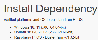

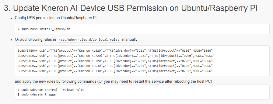

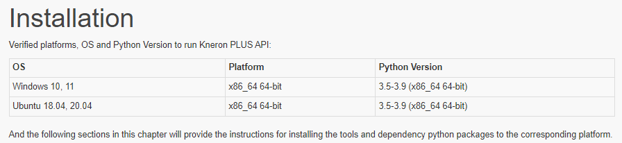

    The error seems to be a failed USB configuration error. Please check if your OS fits these requirements:
    And if you have these USB permissions configured:
    Reference: Install Dependency - Document Center (kneron.com)
    In your previous reply, it said that your Ubuntu version is 22.04, so the Python examples might not work. You could run the C examples instead.
    As for how to look up the error code: If your editor can search inside your file contents, you could look up "KP_ERROR_CONFIGURE_DEVICE_27" and see where the error came from.
