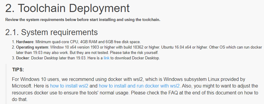

    Update: 關於會支持toolchain的OS,請參照: 2. Toolchain Deployment - Document Center (kneron.com)
