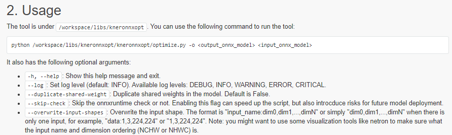

  • Hi,
    You can edit the dynamic input shape by using --overwrite-input-shapes parameter inside Kneronnxopt in our Kneron Toolchain:
    Here is the reference link: Kneronnxopt - Document Center
    I hope it helps.
