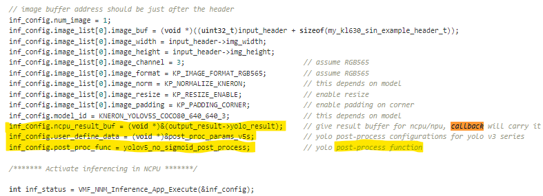

    I tried to develop kl630 firmware code with using kl520_demo_multiple example code fit to my kl630 sdk environment.
    Can I try it this way?
  • Hi Seongyun,
    I'm sorry to tell you this, but unfortunately, no. KL520 SDK and KL630 SDK are very different, so if you don't have the KL630 SDK (the SDK has the firmware code), you will need to contact our sales representative who you purchased the KL630 from for permission. After that, you can refer to the documentation Nick sent in his reply to devleop KL630 firmware code: Create Single Model Example for KL630 - Document Center

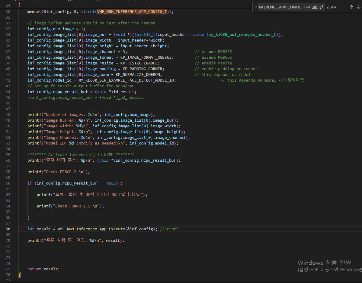

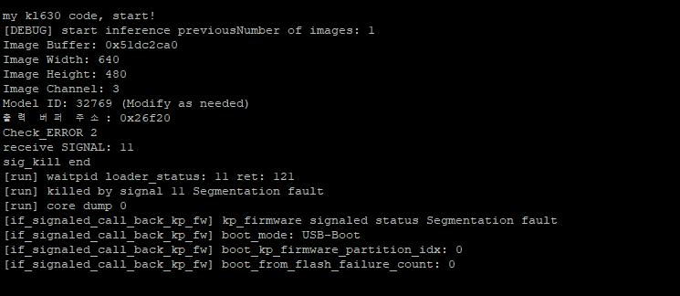

    However, it seems that the execution stops inside the VMF_NNM_Inference_App_Execute function.
    Could you please guide me on how to fix this error?
    I believe the configuration is set up correctly. However, I am encountering an error with SIGNAL 11 and error code 121.
    PLUS -C code is same above zip file. just only changed my firmware code
    Thank you
  • Hi Seongyun,
    The error seems to be caused by the firmware code; there might be parts that are incomplete. Please make sure that you've written a postprocess callback in the firmware.
    If the problem is still not resolved, you could also provide us with your firmware inference app .c and .h codes so we could check them. Thanks!

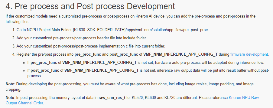

    could you give me some advice about pre_proc_func and post_proc_func development advice? My model is HRNET
  • Hi Seongyun,
    I'm glad you completed the detection successfully.
    For preprocess and postprocess development, you could refer to the link Nick replied to you. It should be at the bottom of the page:
    We can help when users encounter errors using Kneron PLUS and KL630 SDK, but users are responsible with understanding what their model does and writing their own preprocess and postprocess, since the preprocess and postprocess are different depending on the models. If you didn't set up a pre_proc_func, the firmware would use the below data to automatically preprocess your input:
