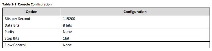

There is a KL730_Development_Environment_User_Guide.pdf inside SDK/01_BSP/01_Document, which would have helpful information such as UART configuration.
Hello.
I checked the UART configuration in the KL730_Development_Environment_User_Guide.pdf document and configured it accordingly.
However, no message is being displayed.

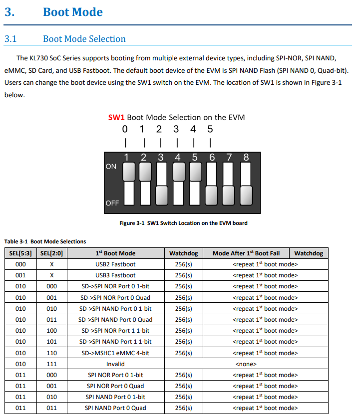

If the firmware is pre-installed, could the Boot mode be the problem?
What else should I check?
Thank you!
The boot mode could be the problem. Please check the switches on the EVM and flip them to the boot mode you prefer.
If boot mode isn't the cause, it could also be a problem with the UART cable. Could you try the following? Thank you!
