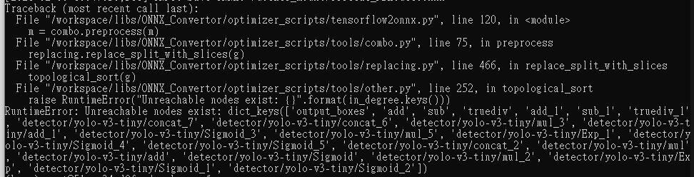

Then I use "tensorflow2onnx.py" to convert, I got this error.

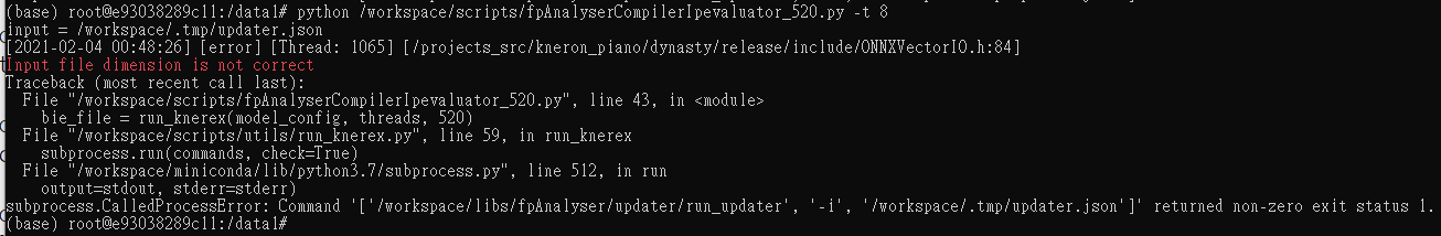

And then, when I do "fpAnalyserCompilerIpevaluator_520.py -t 8" after deleting these nodes, I got another error like this.

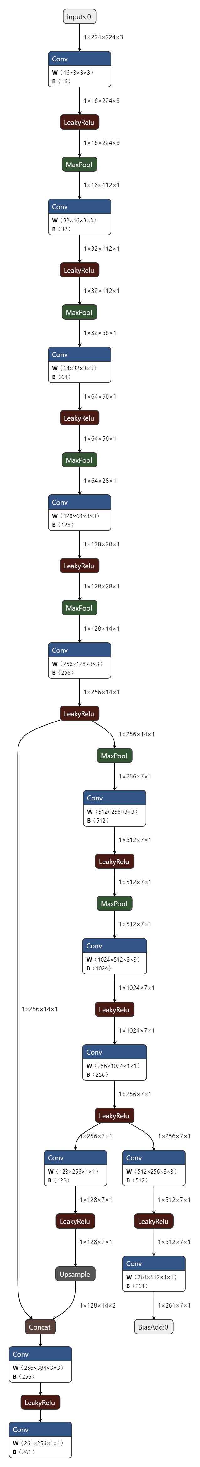

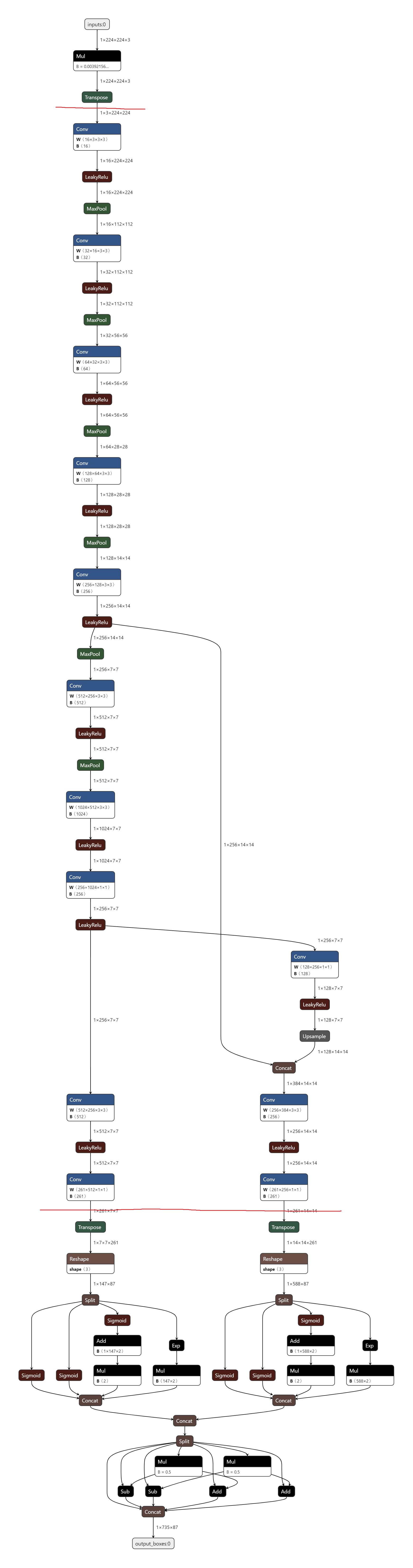

The first network viewer is the TensorFlow model after conversion, and the other one is removed nodes.
I see a couple of issues when editing the ONNX graph:
Here is a graph the ONNX should be edited. Please see the red line.
