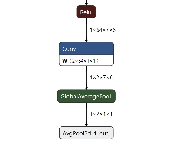

  • As the photo below, the output of LittleNet.onnx is a array with dimension 2x1x1. And you will get different inference result with different image input.
    If you want to run your own model, please refer the document center to convert and compile your model to the Kneron's format.
    And you can get inference result by using simulator or run model on our device directly.

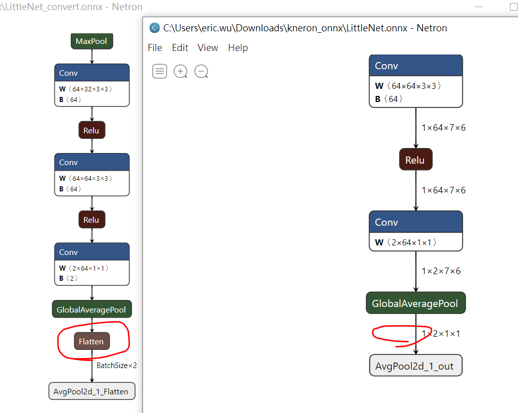

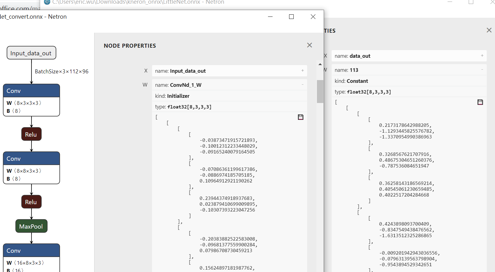

  • The two models LittleNet.onnx and LittleNet_convert.onnx are different. That's why you got different result.
    • The weight between this 2 models are different
    • And the op-type of the last layers are different, too.
    Maybe you can check the flow in Matlab to clarify the cause why model was edited.
