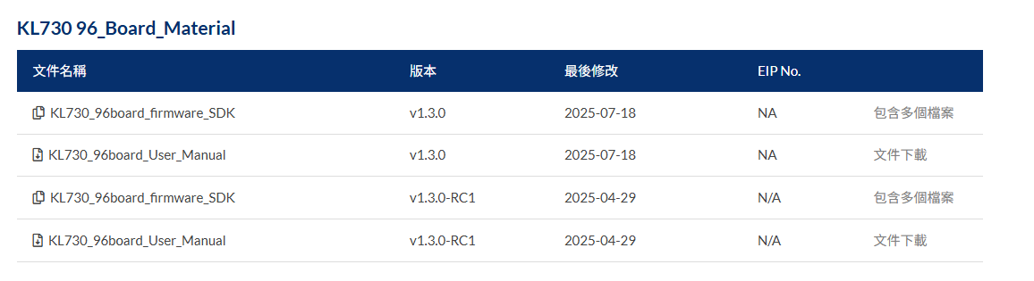

    We recommend you to use your 96 board, or KNEO Pi to run the demo (with the existing sensor and firmware), then refer to the documentation on firmware.
