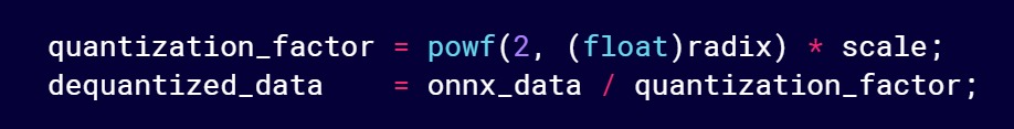

    To connect 2 models, you could write a postprocess function for your first model to convert its output into a fitting input for your second model.
    In KL730, the radix and scale works like this in dequantization:
    You can find more information in Kneron Documentation Center: Convert ONNX & NPU Data on the KL730 Platform - Document Center
