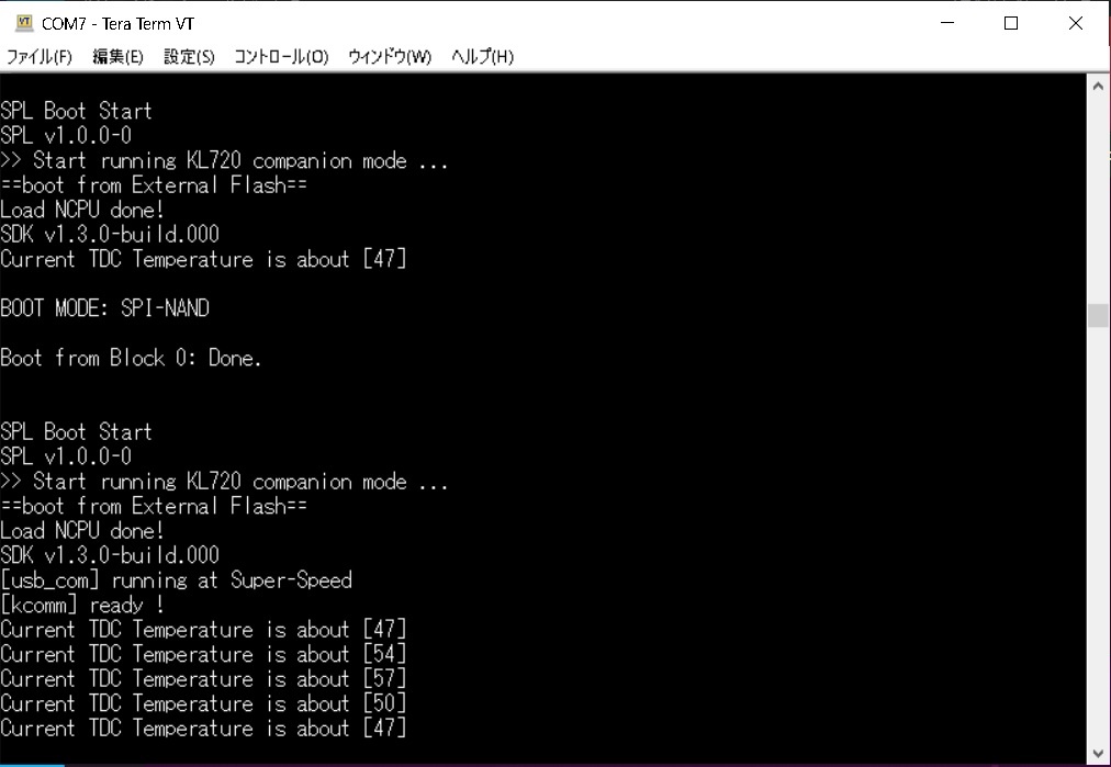

I'm using SDK v.1.3.0.
I could flash firmware of SDK v.1.3.0 to the board.

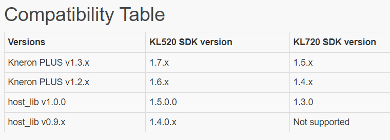

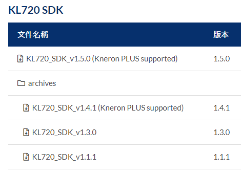

Hi Nagata
a. host_lib(1.1.1 R2) only compatible with SDK_1.1.1

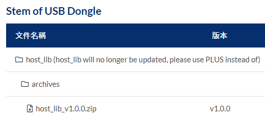

b.Only the release version host_lib_v1.0.0 support command "kl720_isi_load_model" and host_lib_v1.0.0 work with SDK_1.3
The SDK1.3 and host_lib are old files.
It recommand update to use the new kneron_plus to instead of host_lib.

b) I've went to check the examples in host_lib, and unfortunately, it seems like some of the examples have been deleted, but the Document Center wasn't updated. Sorry about that.
We recommend you to use our new Kneron PLUS instead of host_lib, since host_lib isn't maintained anymore and there might be minor bugs in the old programs, and there are more features in Kneron PLUS.
Hi Huang
Thank you for your information of compatibility table.
I will try to use the new kneron_plus to instead of host_lib.
