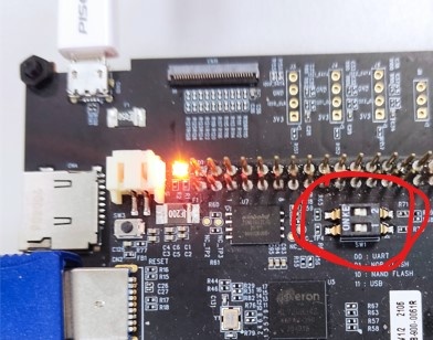

Can someone tell me how to fix it .I am following this document -> http://doc.kneron.com/docs/#720_1.3.0/getting_start_720/
Please tell me how to flash and erase kl720 without getting any errors

Hi William
When execute flash_programmer.py . You need set KL720 boot mode to "00 : UART".

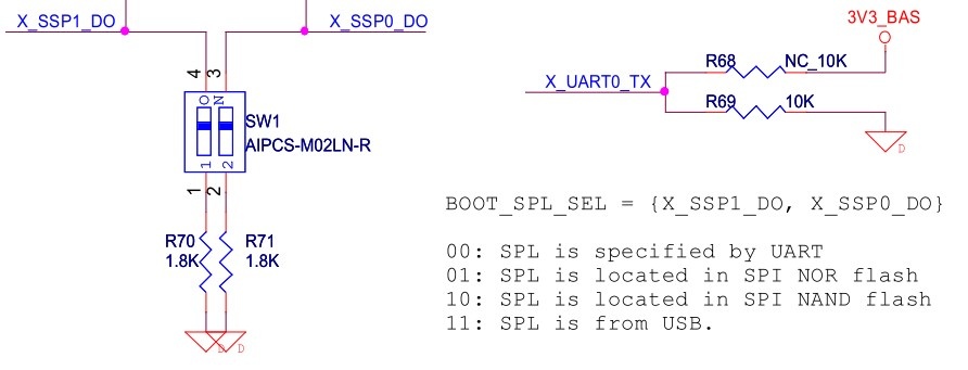

Can you please list all the button configuration please
Hi William
00: for uart flash_programmer purpose
01: SPI NOR boot, this EVB don't have NOR flash.
10: SPI_NAND boot. After program, switch to 10 for normal boot.
11: USB boot , Currently unavailable
Update ...
11: USB boot : use kl720_usb_dfw.exe to update fw_scpu.bin and fw_ncpu.bin
more info KL720_SDK_v1.3.0\beethoven_sw\firmware\utils\usb_minion\app\readme.txt.txt
