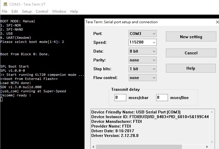

Hi Willian
Same step as document getting_start_720 ch3.
Connect UART0, you cam see two com port, Open teraterm and connect the first one com port with speed 115200.
Setup terminal New-line: Receive: "LF".
Press Reset BTN, You should see the logs .
Remember that, when you connect com port with teraterm, The flash_programmer.py can't work in the same time.
Must disconnect or exit teraterm, then execute flash_programmer.py .
BR
Pow
Thanks Its working now. I am able see the logs in Teraterm and Minicom also
