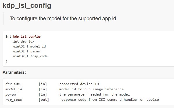

In KL520, ISI mean load model from flash. dme mean load model from usb.
But KL720 remove dme api, and use kdp_isi_config to set model location.
param : CONFIG_USE_FLASH_MODEL = bit(0) # 1: use flash model, 0: use model in memory
