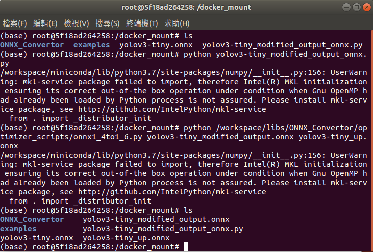

您給的 "yolov3-tiny.onnx" model output shape 不正確,您可以修改 model output shape 修改方式如下,修改後您就可以繼續完成指令
python /workspace/libs/ONNX_Convertor/optimizer_scripts/onnx1_4to1_6.py yolov3-tiny_modified_output.onnx yolov3-tiny_up.onnx,並成功 optimize。import onnx import onnx.utils m = onnx.load('./yolov3-tiny.onnx')#您的model # modify output shape mannually m.graph.output[0].type.tensor_type.shape.dim[0].dim_value = 1 m.graph.output[0].type.tensor_type.shape.dim[1].dim_value = 255 m.graph.output[0].type.tensor_type.shape.dim[2].dim_value = 13 m.graph.output[0].type.tensor_type.shape.dim[3].dim_value = 13 m.graph.output[1].type.tensor_type.shape.dim[0].dim_value = 1 m.graph.output[1].type.tensor_type.shape.dim[1].dim_value = 255 m.graph.output[1].type.tensor_type.shape.dim[2].dim_value = 26 m.graph.output[1].type.tensor_type.shape.dim[3].dim_value = 26 m2 = onnx.utils.polish_model(m) onnx.save(m2,'./yolov3-tiny_modified_output.onnx')#修改後的model以下是成功的執行結果

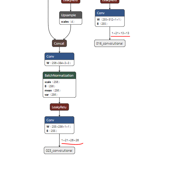

以下是您給的"yolov3-tiny.onnx" model structure
圖中的紅線處應該是1x255x13x13與1x255x26x26才對。
想請問您,不知道您是怎麼取得這個model的,方便的話是否可以反饋給我們。
