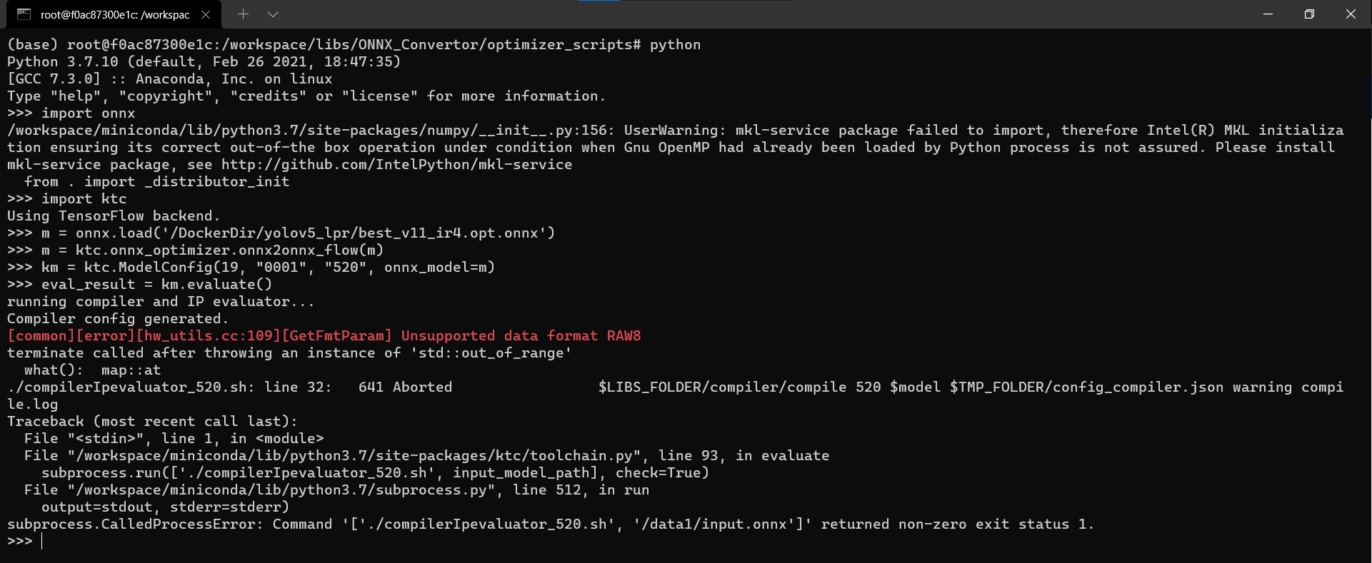

We tried to train yolov5 using this repository: https://github.com/ultralytics/yolov5
After saving to onnx format in version 11 and downgrading the ir_version to version 4, we are able to convert the PyTorch-exported onnx and optimize it using "pytorch_exported_onnx_preprocess.py" in "optimizer_scripts" folder. The resulting onnx file is attached as "best_v11_ir4.opt_onnx.zip".
Then, to convert the onnx file into NEF format, we tried to do the same steps listed in the yolo v3 example for KL520 integration: http://doc.kneron.com/docs/#toolchain/yolo_example/ , But, we encountered an error when performing the km.evaluate() command as depicted in the screenshot. We found that you successfully converted yolov5 to nef model. Can you please share with us how to convert yolov5 model from onnx to nef?

Hi Praveen,
Your question has two parts:
First, the model you are using has unsupported nodes.
Second, if you want to use your model, you can only use KL720 to make inferences. KL520 currently does not support Sigmoid operator.
Before you use "pytorch_exported_onnx_preprocess.py" to export onnx, it is recommended that you first try to remove some operators that are not supported by Kneron docker ToolChain from your Model (e.g. Reshape), and then use
Kneron Linux Toolchain Manual 3.1.5 ONNX Optimization
The API is optimized for .onnx files, such asOnce you have the optimized .onnx, then you can follow the steps in the
Kneron Linux Toolchain Manual 3.2 IP Evaluation
to convert to .nef.@Andy Hsieh
