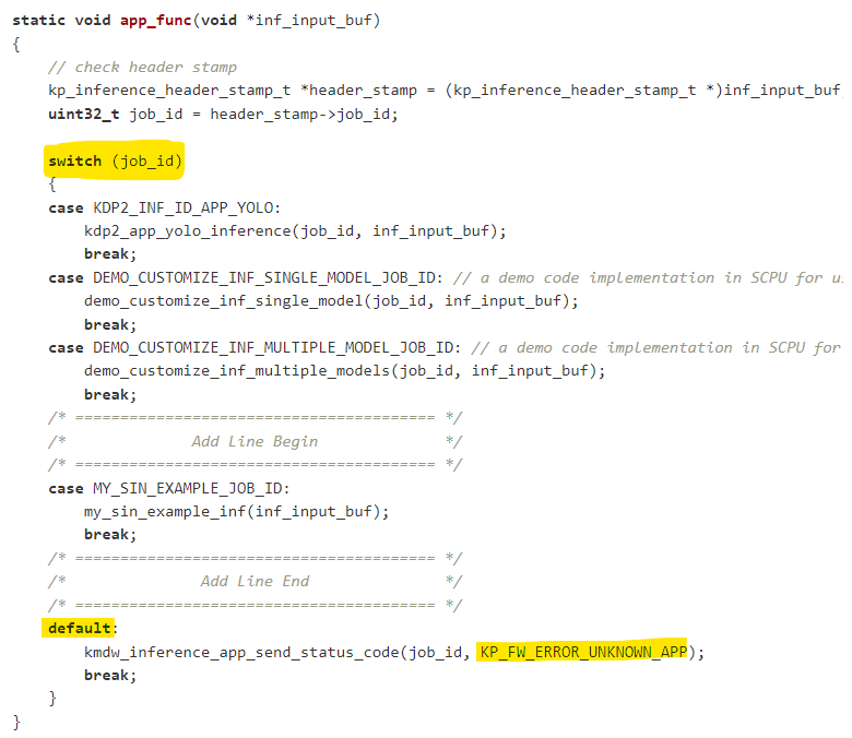

After the application reaches kp_customized_inference_receive() we get a return value of 100 with recv_size=16. From the documentation this seems to correlate to KP_FW_ERROR_UNKNOWN_APP.

3. SCPU Firmware Development
5. Edit main.c
Maybe you should switch your job ID ?

The job ID is 1003 both on the FW side and on the application side.
We copied the example for KL520 and changed it to suit the KL720, since there were no examples for the KL720.
