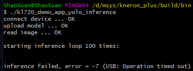

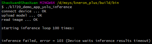

I built the get start example in the Windows 10 environment according to the document center, but it happened
error = 103 (Device waits inference results timeout) or error = -7 (USB: Operation timed out) occurred

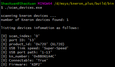

Below is the scanned information:
Where could this be wrong?

    Because my dongle firmware is already KDP2, and there is no KL720 firmware in Kneron_DFUT_v1.2.1, so I did not perform that step

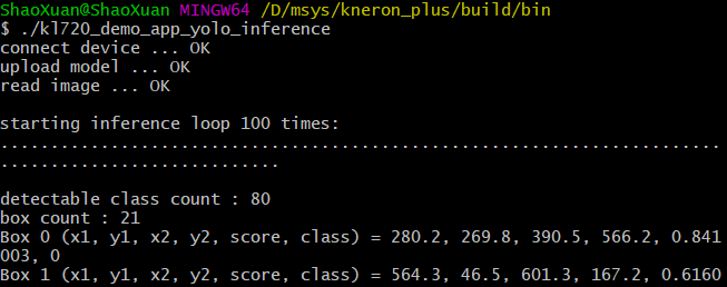

    Hi shao-xuan lin,
    It seems that you need to update firmware again because your plus version is 1.2.1.
    Firmware can be found in ${PLUS_FOLDER}/res/firmware/KL720/, not in DFUT files.
    You can use DFUT to update firmware and retry it.
    Thanks.
  • Otis Hsieh
    Thank you very much for successfully solving the problem
