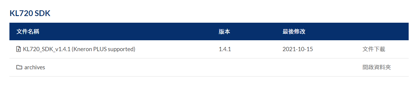

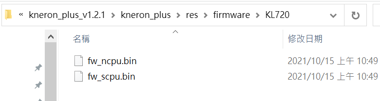

In our kneron_plus project, we provide our 720 firmware code in file: ~/kneron_plus_vx.x.x/kneron_plus/res/KL720
If you want to build your firmware code, we also provide in our website, see here: https://www.kneron.com/tw/support/developers/
Hope this could help you, thanks!

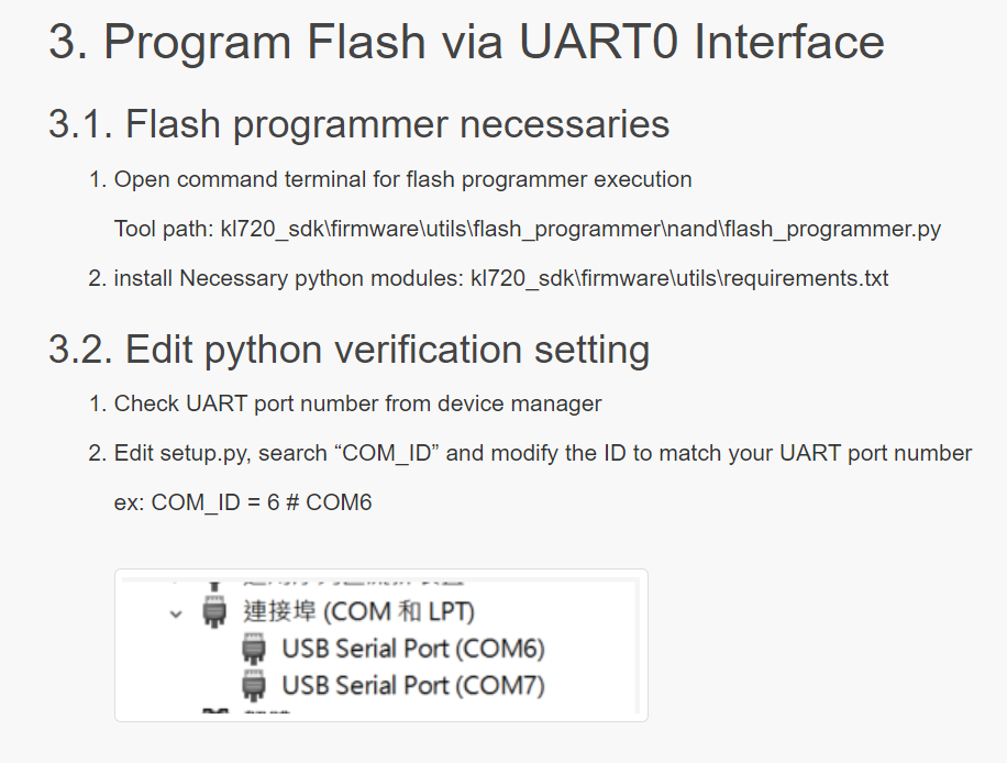

My question is how can we upgrade firmware without JTAG or USB (i.e after we ship the product to a customer).
Do you offer any SDK for DFU mode? Do you have a supported bootloader example?
Hi liron,
What's your development kit? 96-board?
Besides JTAG or USB, we offer UART to upgrade firmware.
You can see the reference below: http://doc.kneron.com/docs/#720_1.5.0/flash_management/flash_management/
