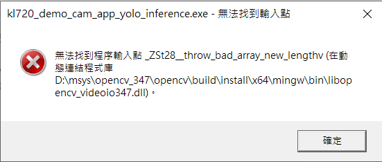

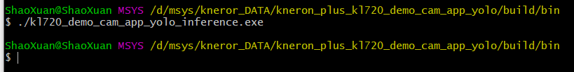

I tried to run the example kl720_demo_cam_app_yolo_inference on windows10 MinGW & Ubuntu18.04 but encountered some Error
Error on windows10 execution:
Error on ubuntu18.04 execution:
how to solve this problem?
thanks!
Hi shao-xuan lin,

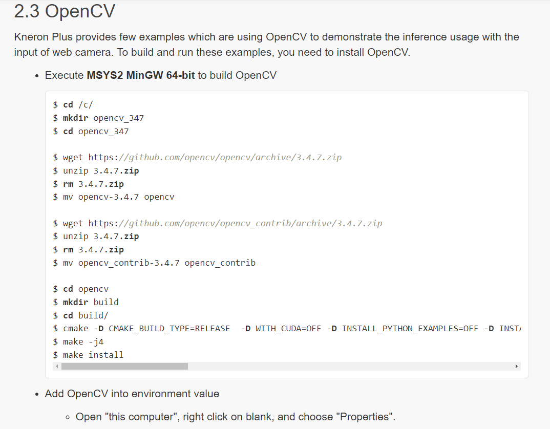

Maybe your environment does not have OpenCV installed. Please make sure you install it and set up the environment variable.
You can see the reference here: http://doc.kneron.com/docs/#plus/introduction/install_dependency/

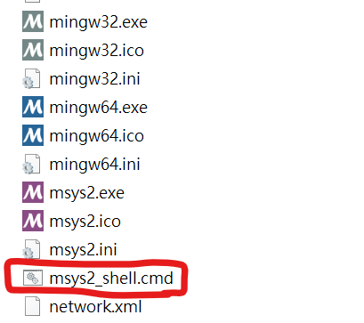

If you have already done it, but it still can not find the OpenCV-related files, you can try this method :
Find out and execute C:\msys64\msys2_shell.cmd instead of msys2.exe, and then execute camera-related app
Hi Otis Hsieh

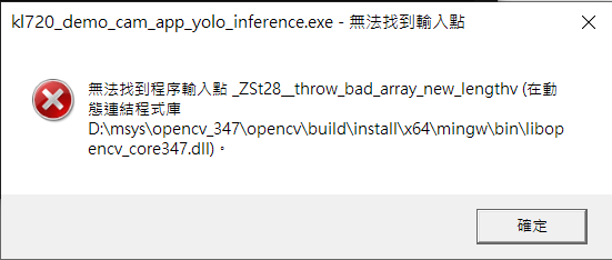

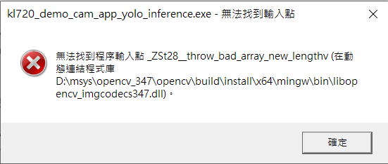

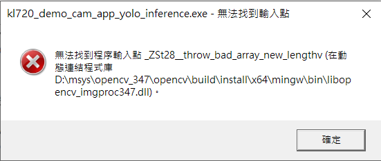

I have already installed the path of opencv and environment variables. Today, I opened kl720_demo_cam_app_yolo_inference.exe directly with the system administrator. There are several errors, and there is no response in msys_shell.cmd
無法找到程式輸入點 (Unable to find program entry point)
在動態連結程式庫 (in the dynamic link library)

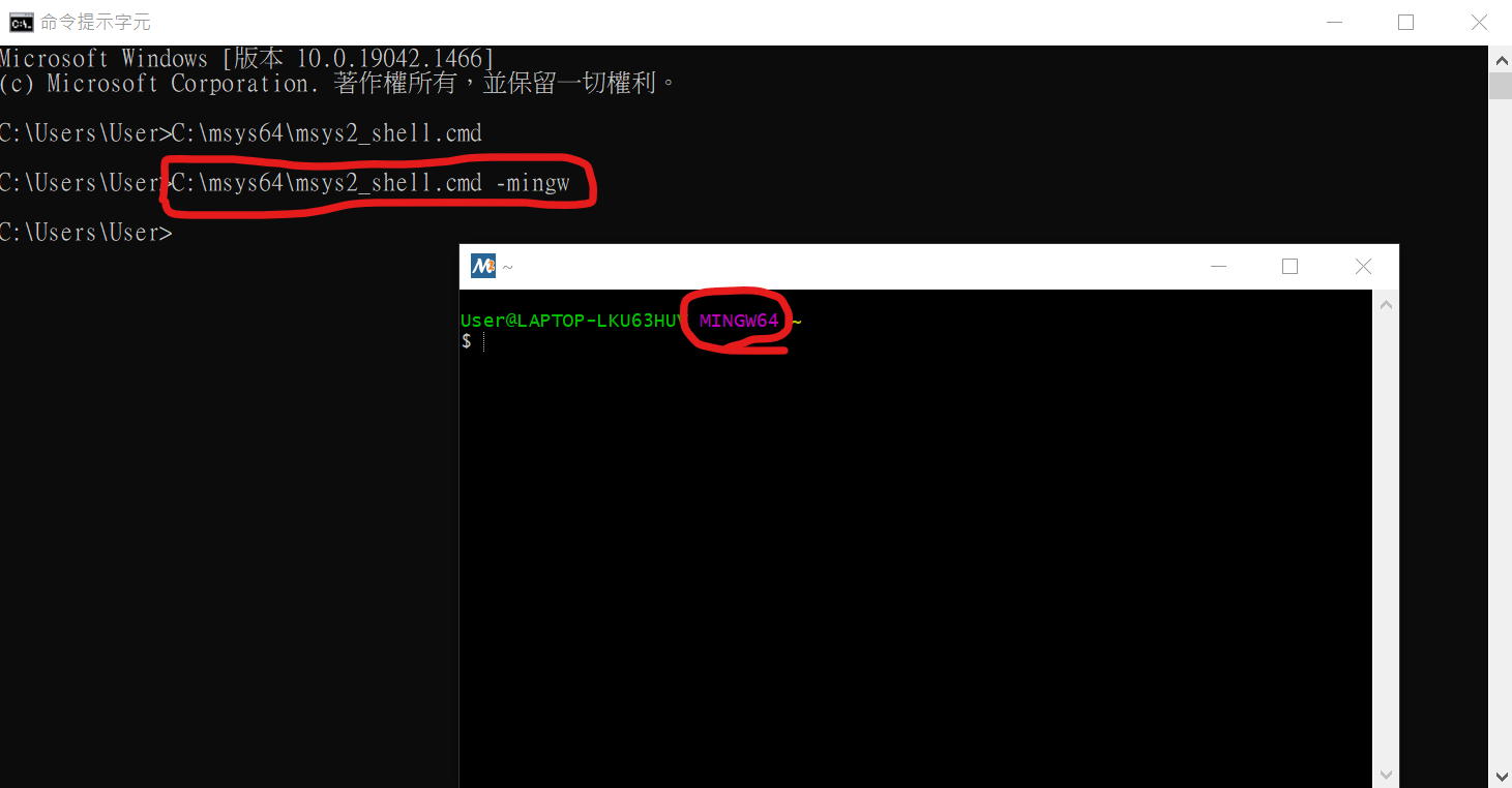

Hi shao-xuan lin,
Please try this: open your command line and execute C:\msys64\msys2_shell.cmd -mingw.
It is not related with system administrator.
Make sure your environment value / path have been set, and rebuild your code.
Thanks.

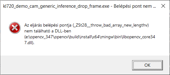

Hi!
I've got similar problem, when I want to run kl720_demo_cam_generic_inference_drop_frame.exe demo program on win10 enviroment. I've used the kneron_plus_v1.3.0.zip source. I built opencv according to the linked description bellow:
It's succesfull build, but when I run kl720_demo_cam_generic_inference_drop_frame.exe from the msys2_shell.cmd console window there is nothing happen
If I run the program from windows console, then I've got the following error
What might be the problem?

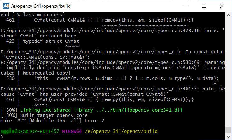

Hi!
I tried to build opencv 3.4.1 from source, but it failed. The build process runs into an error:

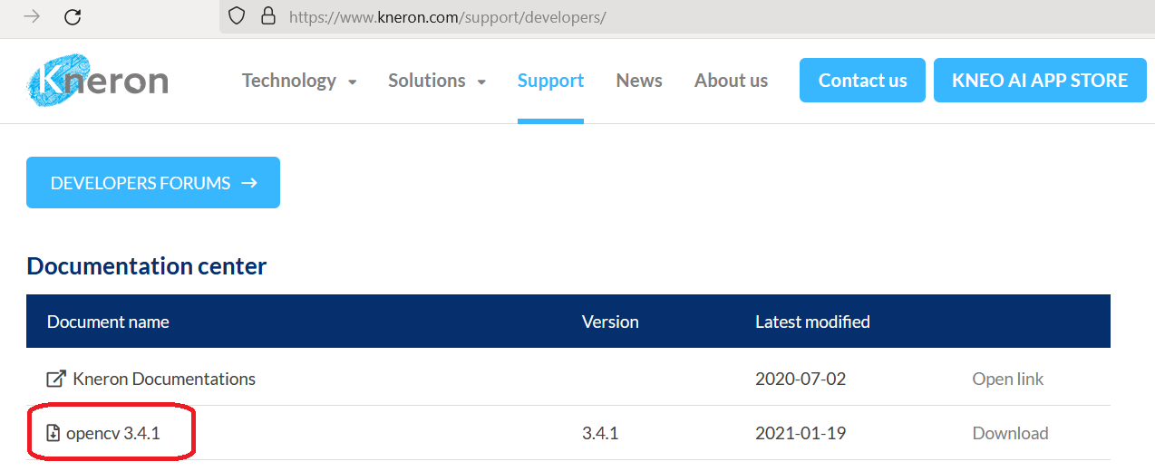

I also tried the prebuild opencv 3.4.1 package that can be downloaded from the kneron site:
but it doesn't work well. With the prebuild opencv package I can build kneron plus examples but when I run the program from console, I've got error messages which is libopenblas.dll missing.

1.Follow document to build Opencv_347 and set Environment Variables.
Install Dependency - Document Center (kneron.com)

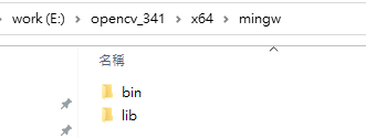

2.download open_341 zip from this link. It don't need to build.
huihut/OpenCV-MinGW-Build at OpenCV-3.4.1-x64 (github.com)
I move the files to opencv_341
To build kneron_plus with opev example need opencv cmake files. It can find in opencv_341\x64\mingw\lib

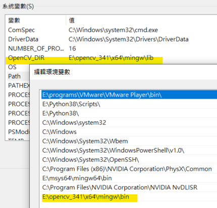

So you need to set Environment Variables -> System Variables
ADD OpenCV_DIR === opencv_341\x64\mingw\lib
And ADD Path === opencv_341\x64\mingw\bin
After setting Environment Variables , must close and re-execute MinGW.
