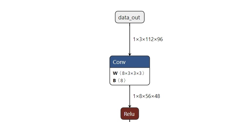

My problem is that I can't make properly make a prediction yet (throws me errors). I was not sure what "data_out" meant in the last syntax (docs weren't clear about it, so I assumed it's the input layer name I assigned when creating the Keras model). When I run the LittleNet example, I can see the prediction properly, but strangely I don't see some of the JSON files LittleNet does have but my model does not. Note that I am quite confident about the input preprocessing so that does not seem like an issue. I am happy to elaborate more and get the conversation going, can someone please verify if my initial steps are correct?
Kaveen
Yes, the input_names=["data_out"] means the input layer name. You can check it in https://netron.app/.
