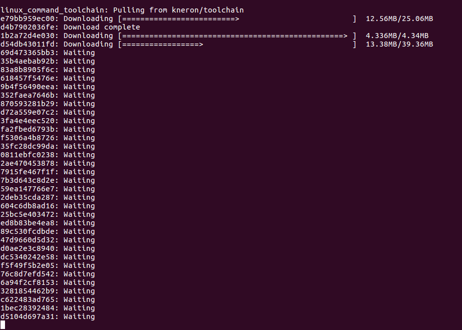

Why can I NOT almost pull image successfully at all?
I have changed image source to "https://registry.docker-cn.com". But almost nothing can be downloaded to my machine, and these progress bar seem dead.
We have update http://doc.kneron.com/docs/ and new toolchain, can reference.
Please try pulling kneron/toolchain:520 for the latest 520 toolchain. By the way, please be careful using the mirror sites. Mirror sites are not always fully synced with the official docker hub site.
