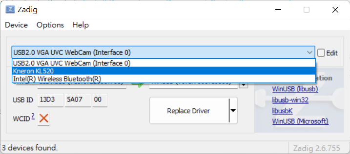

Hi Gopinath,
Could you specify what OS you're using? If you were using Windows, you would need to install Zadig, and if you were using Ubuntu/Raspberry Pi, you would need to configure USB permission.
For more information in regards to installing, you could refer to this link: Install Dependency - Document Center (kneron.com)
Hi Maria,
I am using windows. Yes, I have installed Zadig as well. It does not recognize the KL520 device.
Hi Gopinath,
Thank you for answering the questions. So even if you clicked the Options tab -> List All Devices in Zadig, it wouldn't come up as "Kneron KL520"? Is the USB dongle detected in your Device Manager?
Thanks, Maria! I was able to connect the device successfully.

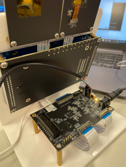

Hi Gopinath,
Are you talking about the KL520 series AI SoC Developement Kit? If so, there is an Assembly Instruction inside.
The board should be set up like the photo below. If this wasn't what you were asking about, please let us know what KL520 SoC you've got.
After setting the board up, you could refer to this link to load the firmware and model as a bin file onto the board's chip: Appendix - Document Center (kneron.com)
To load the firmware and model, you would need the KL520 SDK, which you could download from here: Developers | Kneron – Full Stack Edge AI
Inside the KL520 SDK example_projects, you could use tiny_yolo_v3_host_usbout to do inferencing with the KL520 SoC Development Kit's camera.

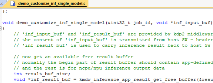

Then, you could refer to KL520 SDK's customized inference when you put your own model's post-process function inside the NCPU. You would need to edit the KL520 SDK firmware (SCPU and NCPU) by using Keil, which you'd need to purchase a license to build the firmware: Introduction - Document Center (kneron.com) / v2.0.x - Document Center (kneron.com)
When you've confirmed that the above flow work on Kneron PLUS, you could take a look at the tiny_yolo_v3_host example in the KL520 SDK to figure out how to control the screen and camera, then edit the tiny_yolo_v3_host example to fit your model in.
