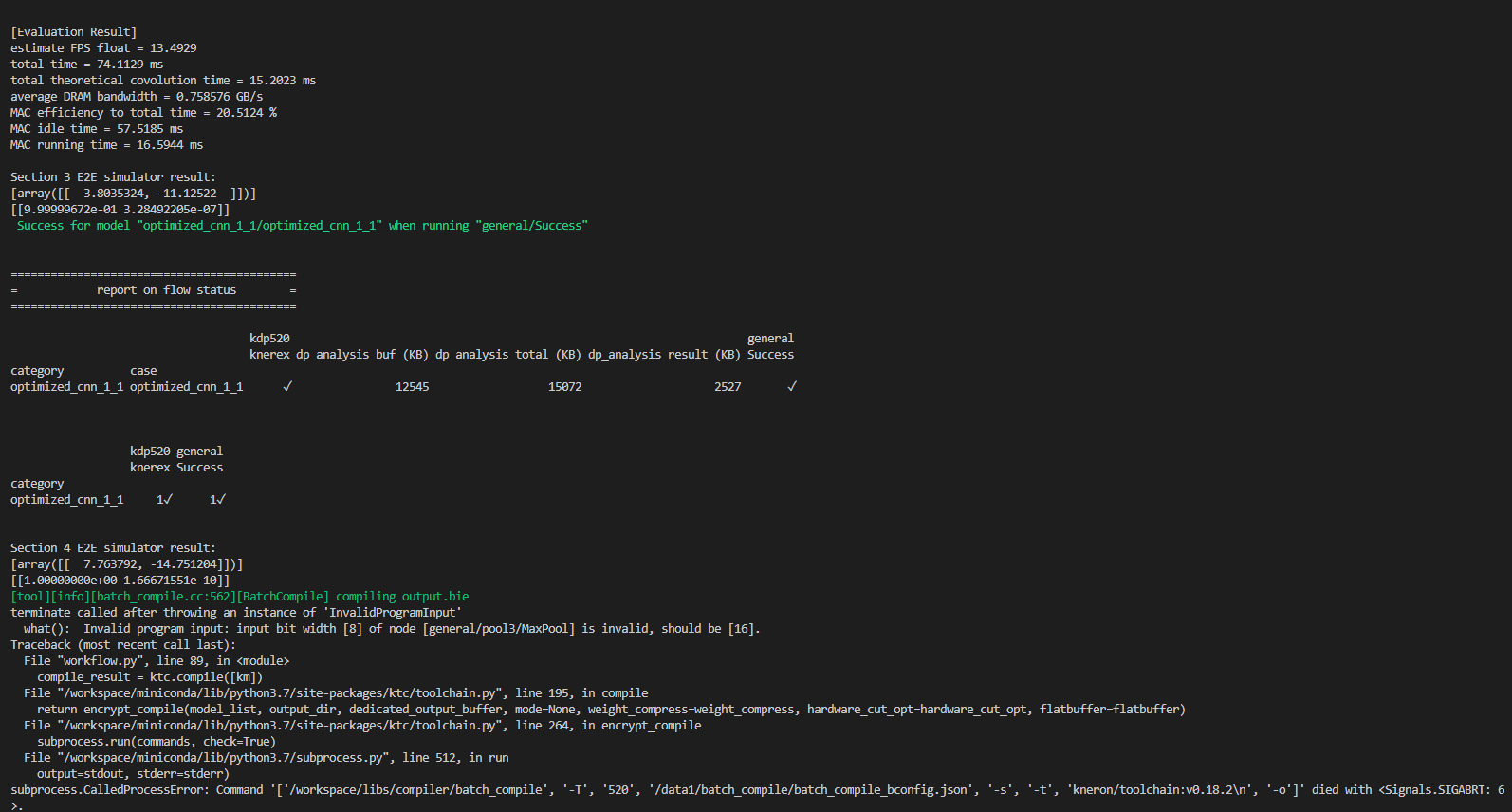

I am trying to generate nef file and I have been getting this error:
input bit width [8] of node [general/pool3/MaxPool] is invalid, should be [16]
I was able to generate the onnx file and also, the E2E simulation generated a success message.
What could be the issue?
  • Hi Anoop,
    Could you run "eval_result = km.evaluate()"? If so, what does the result say?
    There are some possible reasons, such as the input shape is incorrect, or there is an unsupported operator, but we would need more information to find out the actual issue. If possible, could you provide your model structure or onnx file?

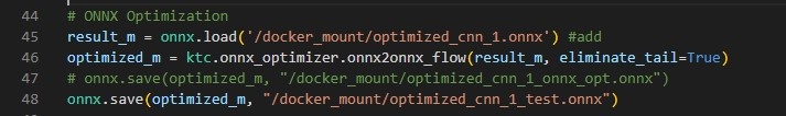

    It seems like this model hasn't gone through ONNX to ONNX. Please refer to Toolchain Manual - Document Center (kneron.com), sections 3.1.2 Pytorch to ONNX and 3.1.5 ONNX Optimization. After using the Python API to go through these 2 steps, you will be able to generate the NEF file:
    1. result_m = ktc.onnx_optimizer.torch_exported_onnx_flow(exported_m)
    2. optimized_m = ktc.onnx_optimizer.onnx2onnx_flow(result_m, eliminate_tail=True)
  • The onnx file that was shared was already optimized as per the toolchain documentation. I could not get the oonx file compiled after running through the workflow.
  • Hi Anoop,
    We ran your onnx model and got the same error as you when we didn't go through ktc.onnx_optimizer.onnx2onnx_flow.
    We optimized your onnx file and successfully generated .nef files for both KL520 and KL720. The code below worked for us:
    After that process, you could run ktc.ModelConfig and ktc.kneron_inference using the new optimized_cnn_1_test.onnx rather than the original onnx file.

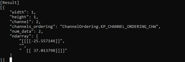

    Thanks for your response. I was able to generate the nef file. However, I would like to understand how to get the inference from device, same inference as the docker version . I followed the documentation and was able to get this result from device :
    The result after inference on docker was: [array([[[[ 3.5251236, -3.8188839]]]])]
    The two results look different.

  • edited October 2022
    I have attached the files here. The image is not converted to RGB again.
    Also,
    Shoud we consider the ndarray generated from the raw inference as the ouput from final layer of the model or is it something else?
    I would like to understand how to interpret the above result. I see the same result for all inputs/images.
    Thanks!
