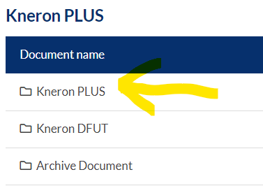

  • Hi Jingyuan,
    May you explain the issue more? Where are the .nef files from? If you'd like to use Kneron PLUS, you could download it here:
    https://www.kneron.com/en/support/developers/
    And you could install the dependencies here. A guide of how to run programs in Kneron PLUS is also in this documentation:
    Install Dependency - Document Center (kneron.com)
    Build Kneron PLUS - Document Center
