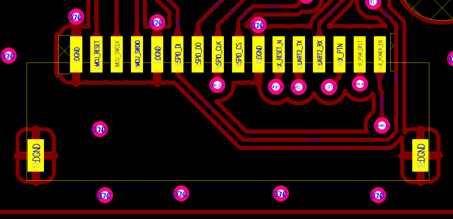

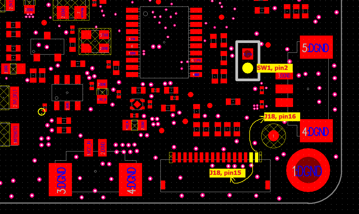

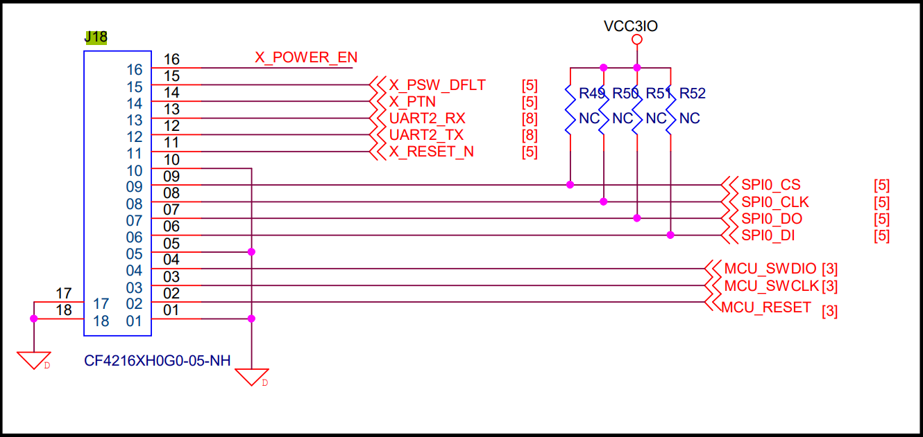

另外請教是否可提供J18的PIN define, 我想接JLINK download firmware.
Best regards
Hi, Harrier:
請參考下圖,
Have a nice day.
