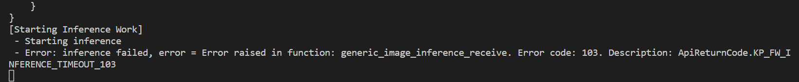

i have now now generated a .nef file to run on the device using the toolchain vs 0.22. I have been able to successfully compile the model , run quantization and also pass the IP evaluation check. but however during inference time i get the following error.
- - Error: inference failed, error = Error raised in function: generic_image_inference_receive. Error code: 103. Description: ApiReturnCode.KP_FW_INFERENCE_TIMEOUT_103

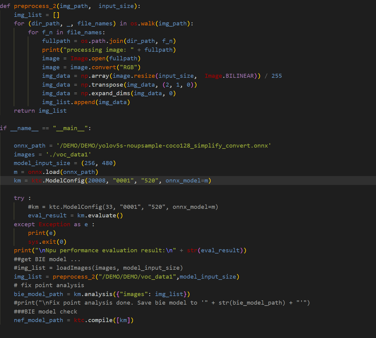

Actually in the repo, there is yolov5s-noupsample-coco128_simplify_convert.onnx which has gone through all the conversions from torch to optimised onnx file. I converted this to bie model using the latest docker tool chain. Please see the code snippet below ,i have used to create the .nerf model, i then proceeded to running inference using the exported nef model. i am currently using the Kneron PLUS v2.1.1 and running the default examples.
Running the inference then raises the time out exception issue!.

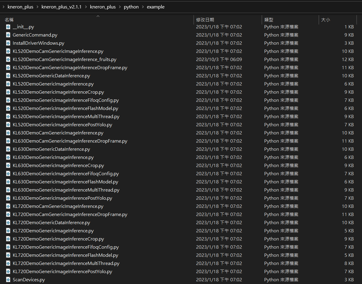

If convenient, you can also provide me your platform with a default example of how the nef model runs its reasoning after you have exported the nef model.
For example,
Hi @Andy Hsieh thanks for the response, i am running on the KL520 device. i have ran the KL520DemoGenericImageInference.py script to test this out, please see output below:

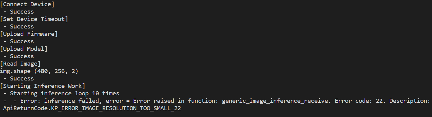

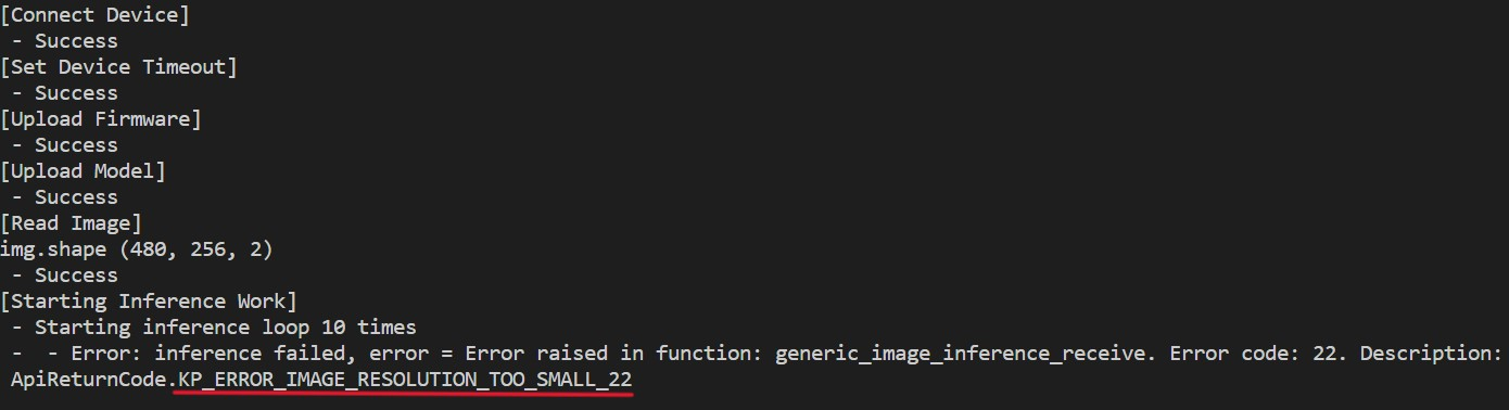

I saw your error message, it may be due to the fact that the image size of the input image does not match with the model you want to infer, you can check that your input image matches with the image size of the model input.
(As a reminder, the size of the input image must be larger than or equal to the model input.)

hi @Andy Hsieh apologies i had accidentally attached the wrong image in my previous message, i had resolved that error a while back😀. that is not the error i am currently facing. I have made sure the size of input image matches the model., the error i face is with a time out during the inferencing operation. Please see below:

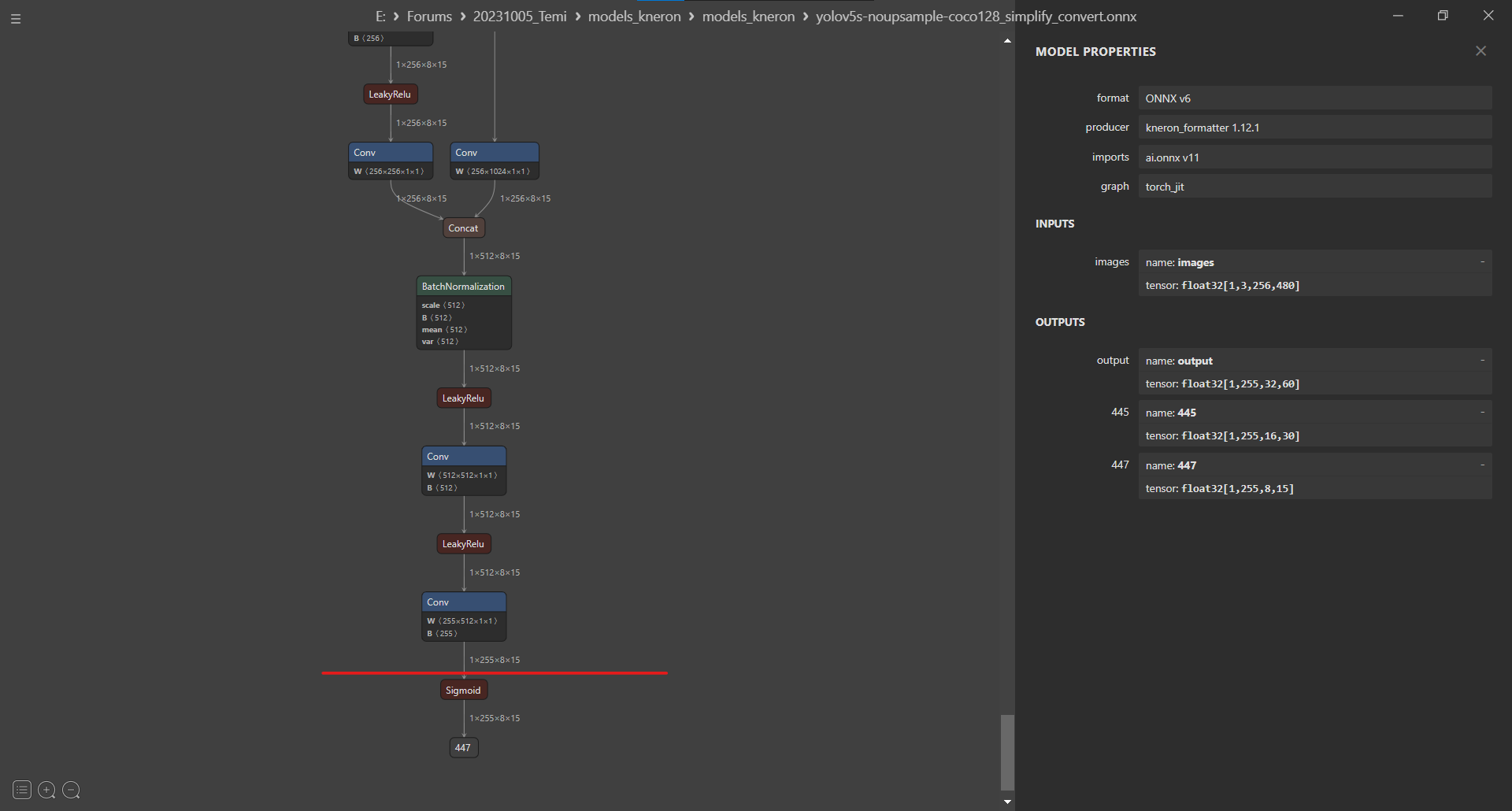

Seeing that you are using an .onnx model, I found that the reason for this is that your onnx model has Sigmoid operators at the end. (e.g. onnx::Sigmoid_442, onnx::Sigmoid_444, onnx::Sigmoid_446)
When using KL520 platform you can remove the sigmoid operators first and then use Kneron Toolchain to convert to .nef model, then it should work fine.

You don't have to remove it from pytorch, you can use Kneron Toolchain's Model Editor function or a third party model editor.
Because KL520 doesn't support Sigmoid, it may cause your error problem.
