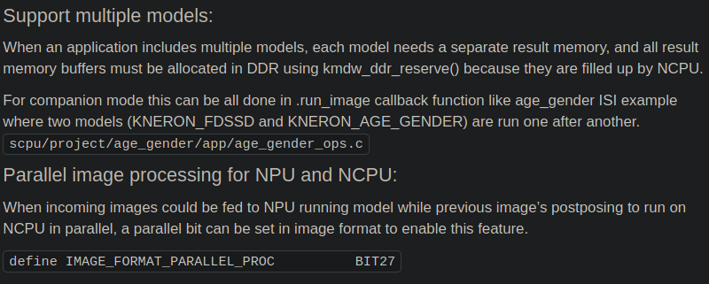

  • Thanks. I am trying to use multiple models in a single application and I can see from the docs that an example is already doing it:
    However, I cannot find such example (age_gender) inside the "scpu/project" folder (there is only the "tiny_yolo_v3" foider).
    Where can I find it?
    Thank you.
  • For business policy, we no longer provide full application code of "age_gender" for free. But you can still find the model binaries in host_lib example (\host_lib_v0.9.0-early\app_binaries\KL520\age_gender).
    (Download host_lib_v0.9.0-early.zip from Kneron Developers)
    For the multi-models purpose, please combine your models to single binary by toolchain, and use api "kdp_dme_configure" to config each model id so you can run "kdp_dme_inference" with the model id which you hope to perform.

    I see. However I am looking for an example of a ISI implementation of multi-model, not a dme one.
    I suggest you to specify inside the documentation that the age_gender code is no longer available because it is not clear from what I saw.
    Thank you very much for you help.

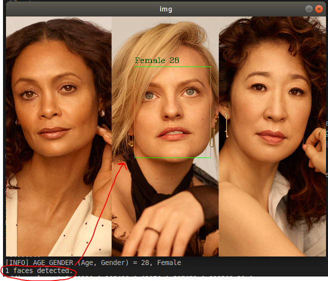

  • Hello Ethon,
    I managed to make the "age_gender" model work in ISI mode. However, when multiple faces are visible in a input image, only one face is detected.
    My question is: is it correct to have only one output bounding box from the program?
    I would like to detect all the faces but when I pass the struct "fd_age_gender_s" to "kdp_isi_retrieve_res", count = 1 but it should be count = 3.
    Thank you.
  • Hi Paolo,
    Yes, now the App. age_gender only returns result with the face which is the highest score.
    If you just want to detect where the faces are, please refer to the example ssd_fd and you can get result with all the faces.
  • Ok, thank you.
