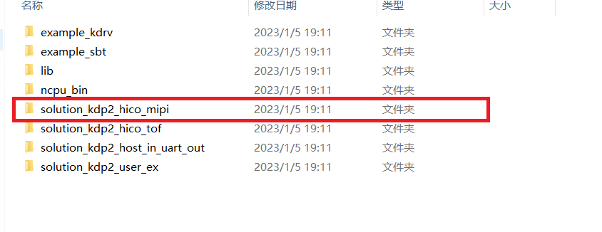

如何跑SDK中的demo code "solution_kdp2_hico_mipi"?
我们购买了development Kit (KL720_DMB_BGA386_SCHEMATIC_VOP2)。之后想学习一下怎么把它跑起来,下载了SDK,查看到有solution_kdp2_hico_mipi这个例子,但是目录中只有SCPU的代码,不知道NCPU也是下面说1-3步中是怎么做的,为了跑这个demo有相对应的NCPU例子吗?

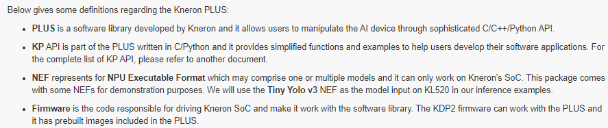

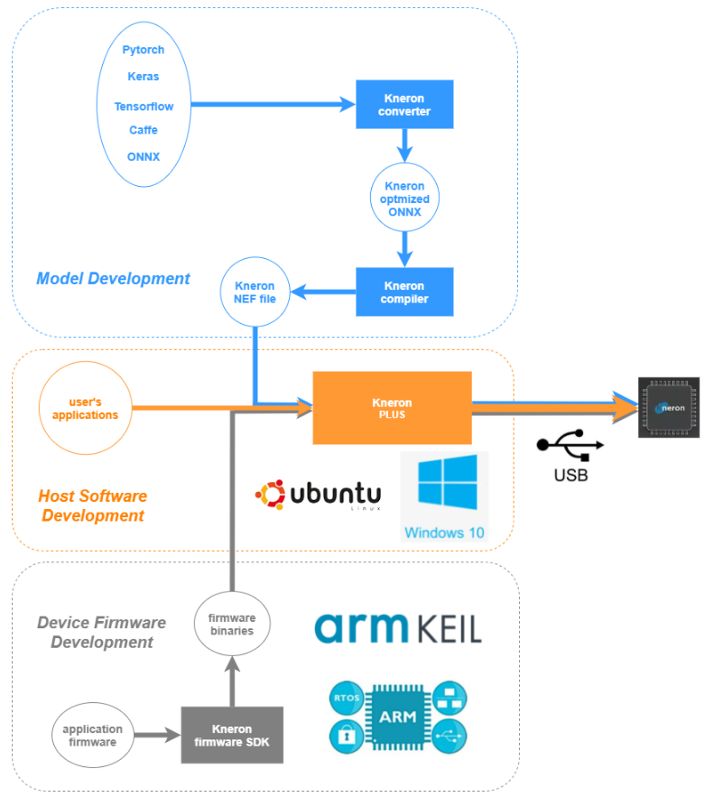

Below is a recommended flow of AI application construction:
- Prepare your AI model(s)
- Convert and verify model(s) via Kneron Toolchain
- With a PC, it is convenient to verify converted NEF models and easy to test variant data on target device via Kneron PLUS
- note: If your application is designed as host-companion architecture with USB interface, you can stop here and go ahead with Kneron PLUS.
- See Kneron PLUS - generic inference for model-only verification
- See Kneron PLUS - customized API for model and pre/post process function implementation.
- Replace implementation of data Input and result output flow according to application requirement if your application is not designed as host-companion architecture. That's to replace the related code for data-in/data-out over USB interface which is designed for Kneron PLUS control protocol library by your implementation.
For example, to consider an application which requires a connected MIPI sensor to chip as image source and output result through UART interface.
After step 1-3, implementation of model inference flow and verification is done. Refer to the diagram below. The inference flow behind kmdw_inference_image_dispatcher_thread is verified and ready. All you have to do is to modify the firmware, solution_kdp2_user_ex, which is used with Kneron PLUS for model verification by replacing the threads for data/input and result/output to become a customized firmware. The implementation is easy by calling kmdw_fifiq_manager_XXX
() APIs to arrange data flow for inference tasks.

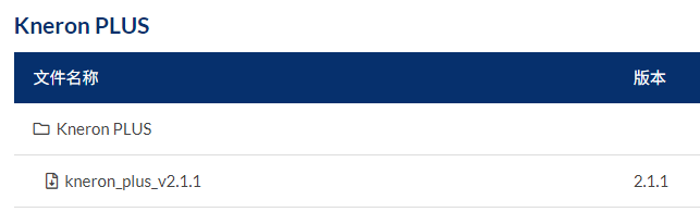

如果沒有Hico MIPI camera,可以先跑Kneron PLUS的基本範例。Kneron PLUS有提供範例模型可以直接使用。
您可以在Kneron的網站下載Kneron PLUS,然後用現有的firmware (SCPU跟NCPU)來跑範例。
下載網址: 开发中心 | Kneron - 人工智能无处不在
燒錄firmware方法(KL720): Getting Started - Document Center (kneron.com)

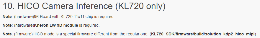

Enterprise的範例demo: Run Examples for Enterprise - Document Center (kneron.com)
Hi Maria,我下载了 KL720_SDK_2.1.0 。 里面有个MIPI的demo, 这个SDK的demo跟Kneron PLUS Enterprise (含有Hico MIPI的demo code) 里面的demo是不同的?
KL720 SDK的solution_kdp2_hico_mipi與Kneron PLUS Enterprise的HICO Camera Inference demo是相對應的。
要跑HICO Camera Inference,會需要build在KL720 SDK裡面的solution_kdp2_hico_mipi,生成firmware燒進KL720板子,才可以讓Kneron PLUS Enterprise裡面的HICO Camera Inference demo成功執行。

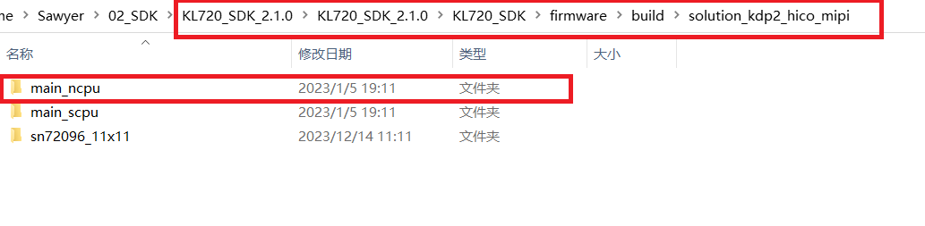

可是我看到下载的SDK的MIPI示例NCPU里面是空的
KL720 SDK裡面有包含SCPU與NCPU,但是NCPU的project位置並不是直接放在solution_kdp2_hico_mipi裡面。
Maria Chen, 你说在别的地方,是要我早请到权限之后才能看到NCPU的例子吗?如果不是在MIPI同一个目录下
除非有用自己的模型的需求,一般來說NCPU不需要做改動。您要跑HICO Camera Inference Demo的話,可以直接使用在PLUS裡面已有的fw_ncpu.bin,不需要額外去build NCPU。
如果要編輯或build NCPU,會需要跟我們的業務窗口申請開放權限,也需要有DSP (Xtensa Xplorer)的授權。
