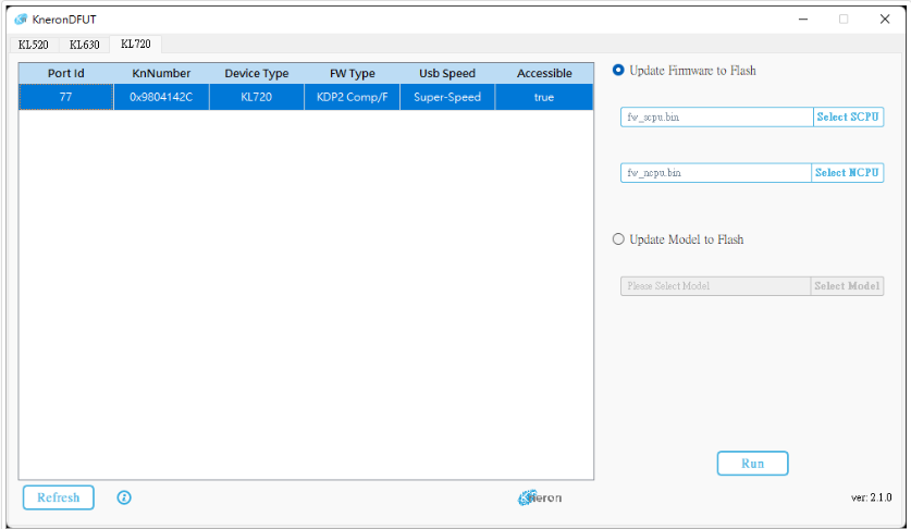

DFUT can only be used for Linux version 18.04
what should I do now?
Hi Haresh,
Maybe you can try to build a console DFUT instead of pre-built DFUT GUI tool we provided.
step1: Download the latest PLUS here
https://www.kneron.com/tw/support/developers/
Or download PLUS v2.2.0 directly by following link.
https://www.kneron.com/tw/support/developers/?folder=Kneron%20PLUS/Kneron%20PLUS/&download=1735
step2: Refer to the document to build on ubuntu and add an extra command.
"cmake -D WITH_DFUT=ON .."
https://doc.kneron.com/docs/#plus_c/getting_started/#3-build-plus
Or you can just follow the commands below:
$ cd kneron_plus/
$ mkdir build
$ cd build/
$ cmake -D WITH_DFUT=ON ..
$ make -j
Then you will find the executive "DFUT_console" in /kneron_plus/build/bin
All functions on DFUT can be used by DFUT_console, too.
