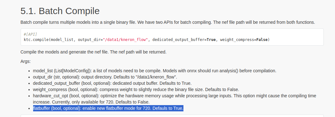

Hi Tri,
The NEF files can't be combined because the versions of the NEF files are different: one is v0, and the other one is v1. You could check the versions of the NEF files with:
./kneron_nef_utils --info path/to/file.nef
To resolve this, you could edit the flatbuffer to False in batch compile to disable flatbuffer mode so that it compiles v0 NEF files.
(You may use either ktc.compile or ktc.encrypt_compile)
Then, you should be able to combine both v0 NEF files.
Reference: 5. Compilation - Document Center (kneron.com)
