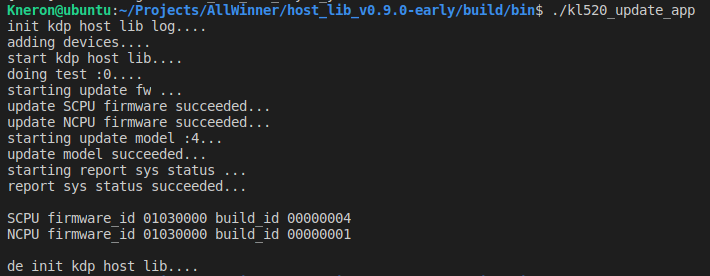

I uploaded an existing model as follows:

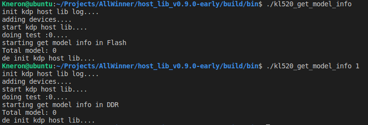

Now I used the get_model_info example and I get:
As you can see "Total model" is equal to 0 while it should be 1. I tested this procedure both on a VM running Ubuntu and on a Linux real machine.
Any idea on how to make it work? I would like to get the model id

Hi Paolo,
The issue was caused by the scpu fw error with the binary fw_scpu.bin in folder age_gender.
Please copy the "fw_scpu.bin" in /host_lib_v0.9.0-early/app_binaries/KL520/tiny_yolo_v3 into /host_lib_v0.9.0-early/app_binaries/KL520/ota/ready_to_load, and use the example "/kl520_update_fw.exe 1" to update fw_scpu.
You can get model info again and would get return values as following
Perfect, it works. Thank you.
