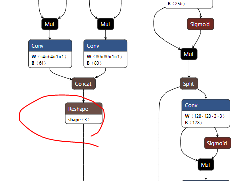

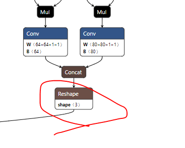

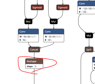

    3. Since there are nodes that aren't supported by KL720 (such as ReduceMax, Gather, Exp, etc.), you could use model editor (editor.py) to cut off all the nodes after Transpose (including Transpose too). You could cut them off, then add back the nodes that were cut off in your post process function. Either that, or you could come up with a way to change these nodes to nodes that are supported by KL720
    I see that you have cut the unsupported nodes off, but you could also move transpose and reshape to your post process function, so that there would be a big chance for them to accelerate.
  • Hi Haresh,
    Our model team checked your model, and we would recommend you to try cutting the Reshape and Concat operators and moving them to post processing even though they're supported by KL720. If that doesn't work, please cut the Transpose operator as well.

    Thank you for explaining how you processed your model. We've checked the onnx2onnx.onnx file, and it seems like the operators mentioned above are still there. As we have recommended you earlier, even if the operators Reshape and Concat and Transpose are supported by KL720, it is better to cut them and write the postprocess separately to avoid the Quantization model generation failed error, or change the operators to other operators that are supported.
