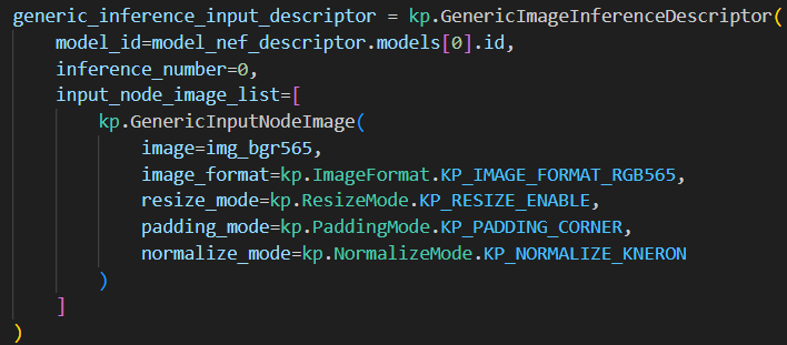

    There is an faster and easier way: For Python code, you could refer to KL720DemoGenericImageInference.py and change the model_id inside the generic_inference_input_descriptor each time before you inference.
    An example flow would look like this:
    -Set the model_id inside generic_inference_input_descriptor to the model you'd like to use
    -Inference the image by using generic_image_inference_send
    -Receive the raw result with generic_image_inference_receive
    -Process the result so that it fits the input of the next model
    -Set the model_id inside generic_inference_input_descriptor to the next model and set the other parameters (For example, if your second model will inference a specific part of an image from your first model's inference result, you could crop the original image and use that as the image for GenericInputNodeImage. Please refer to KL720DemoGenericImageInferenceCrop)
    -Inference the image again by using generic_image_inference_send
    If you are not using an image, you could also take a look at KL720DemoGenericDataInference.
