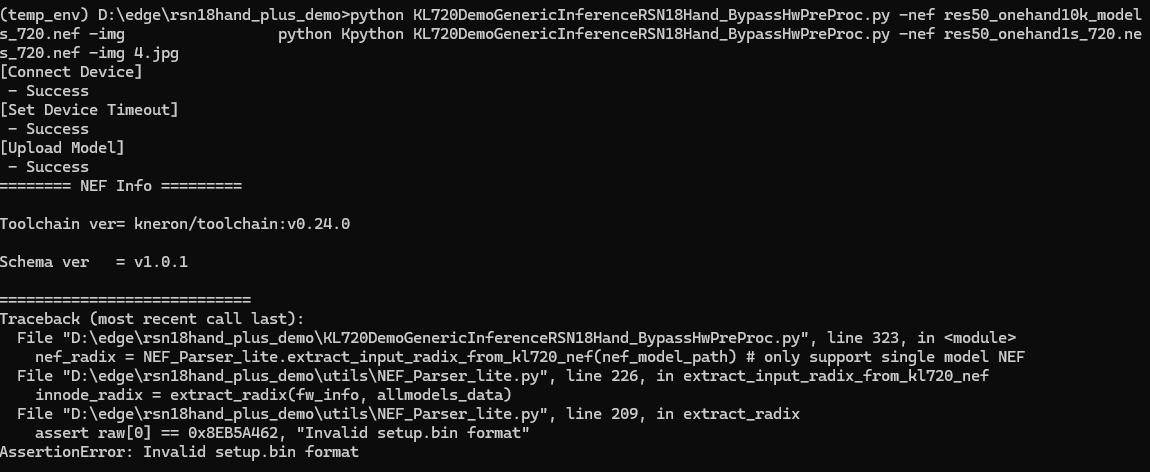

So, when I run the inference using the example script:
KL720DemoGenericInferenceRSN18Hand_BypassHwPreProc.py
I face the error:
Please assist and thanks in advance.
It seems like something is off with the nef file. Could you provide us the nef file and jpg file you used, and the python file if you edited it, so we could look into them? Thanks!
