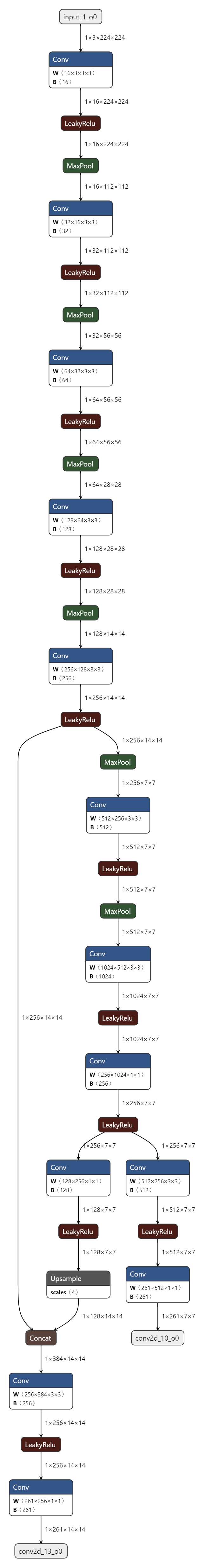

You can reference my final convert results.
I didn't edit any node removal, but success all convert steps.
Remark: No matter what I use to convert(Ex:pytorch2onnx、tensorflow2onnx) only "keras2onnx" successful.

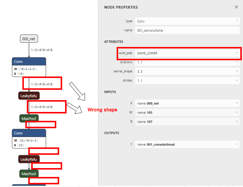

Hi @Raef Youssef :
The root cause of this issue comes from a auto_pad bug in onnx 1.4.1,
In onnx2onnx, we use the builtin function ( shape_inference ) in onnx for calculating the shape of feature map between node and node, which is required by tool chain. If shape is wrong, quantization and compiling go wrong.
In the onnx you provided, we can see there are many auto_pad attribute in Conv and MaxPool, and some wrong shape information.
I try to modify the project you provided (https://github.com/jkjung-avt/tensorrt_demos/tree/master/yolo),
modified auto_pad in Conv here:
https://github.com/jkjung-avt/tensorrt_demos/blob/master/yolo/yolo_to_onnx.py#L590
and auto_pad in MaxPool here:
https://github.com/jkjung-avt/tensorrt_demos/blob/master/yolo/yolo_to_onnx.py#L836
After experimental modification (just hard coded the value),
the model could be compiled successfully.

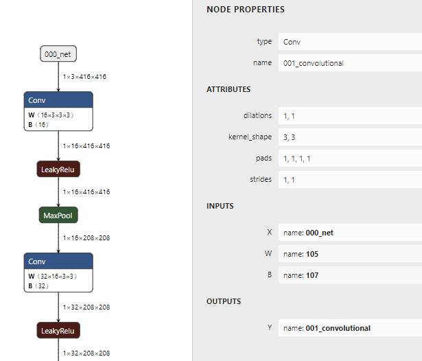

the correct onnx:
If you really want to use the model in this project,
I recommend you can modify the source code to set correct padding value.
