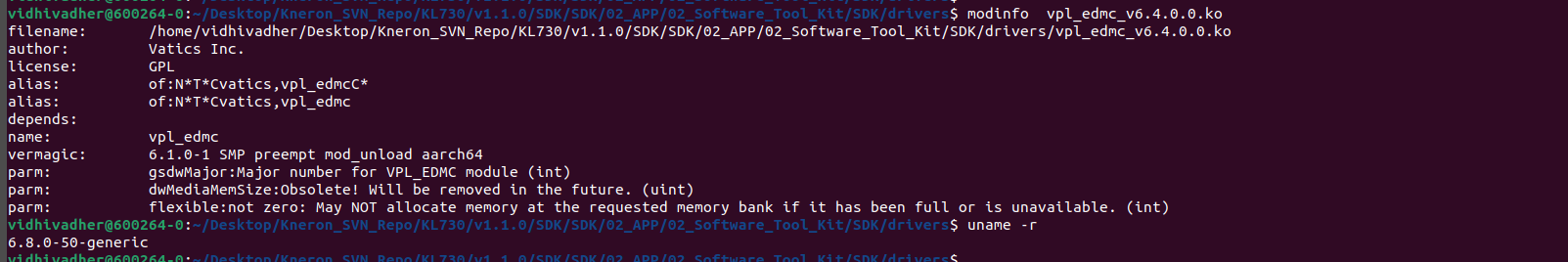

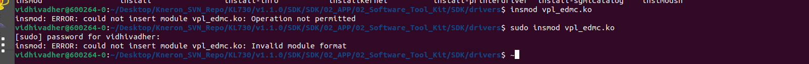

Thank you for responding. Yes I had a typo in subject, its actually KL730 board.
Apart from it, the above mentioned logs are from EVM module. When I tried to load the module in my host system, I got the same error.
Please see above snapshot attached.
Also there's one thing I observed, the Host system kernel version is - 6.8.0-50-generic and EVM has the kernel version as - 6.1.0-1. Can this cause any such issues? Though I verified that the module is compatible with the kernel version of EVM.
