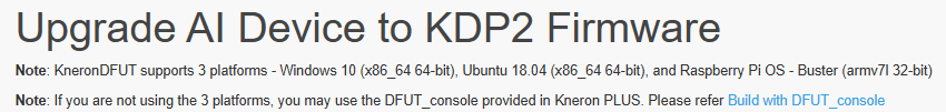

In my project, i'm using the Banana Pi P2 Zero with Armbian to access the KL520.
So, i'm interested in use the Kneron DFUT on this board to flash the firmware but only the Raspberry Pi binary is available. How can i proceed in this case?
Hi Franklin,
These are the platforms you can build and run Kneron PLUS on:
If you are not using the above platforms, to flash the KL520 firmware, you could download Kneron PLUS and try building the DFUT console:
Build with DFUT console: Build Kneron PLUS - Document Center
Then, you could use the console to update the KL520 to USB Boot mode or Flash Boot mode, then upload the firmware.
DFUT console: Run Examples - Document Center

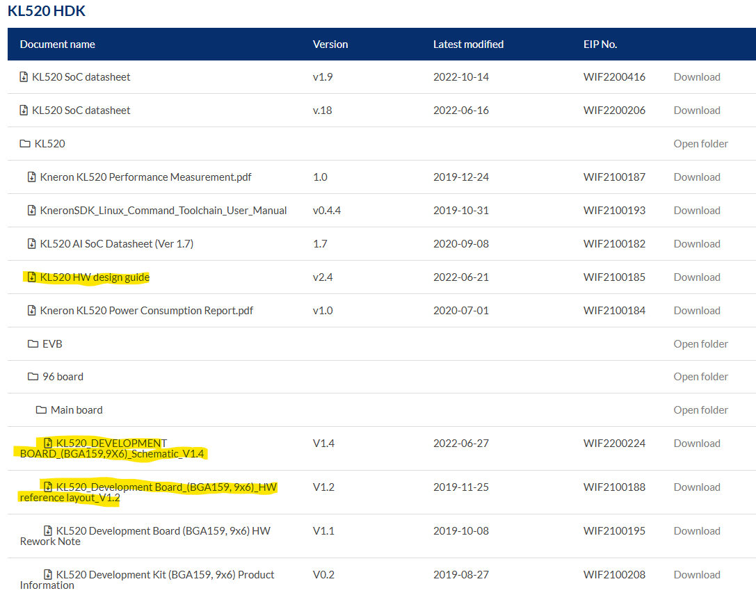

Hi again Maria,
Is there any HW library available for KL520 TFBGA 8x8 159io (Symbol, footprint)? As reference, we're using Kicad
Hi again Franklin,
For KL520 hardware information, you could refer to these documents available on our Developer Center: Developers | Kneron – Full Stack Edge AI

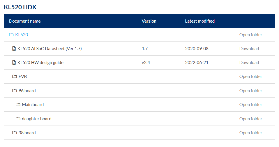

Hi Maria,
The 96 board/Main board files are not available for me. Can you send me, please?
Hi Franklin,
The files are only provided to limited users. Please contact your purchase window to get access rights

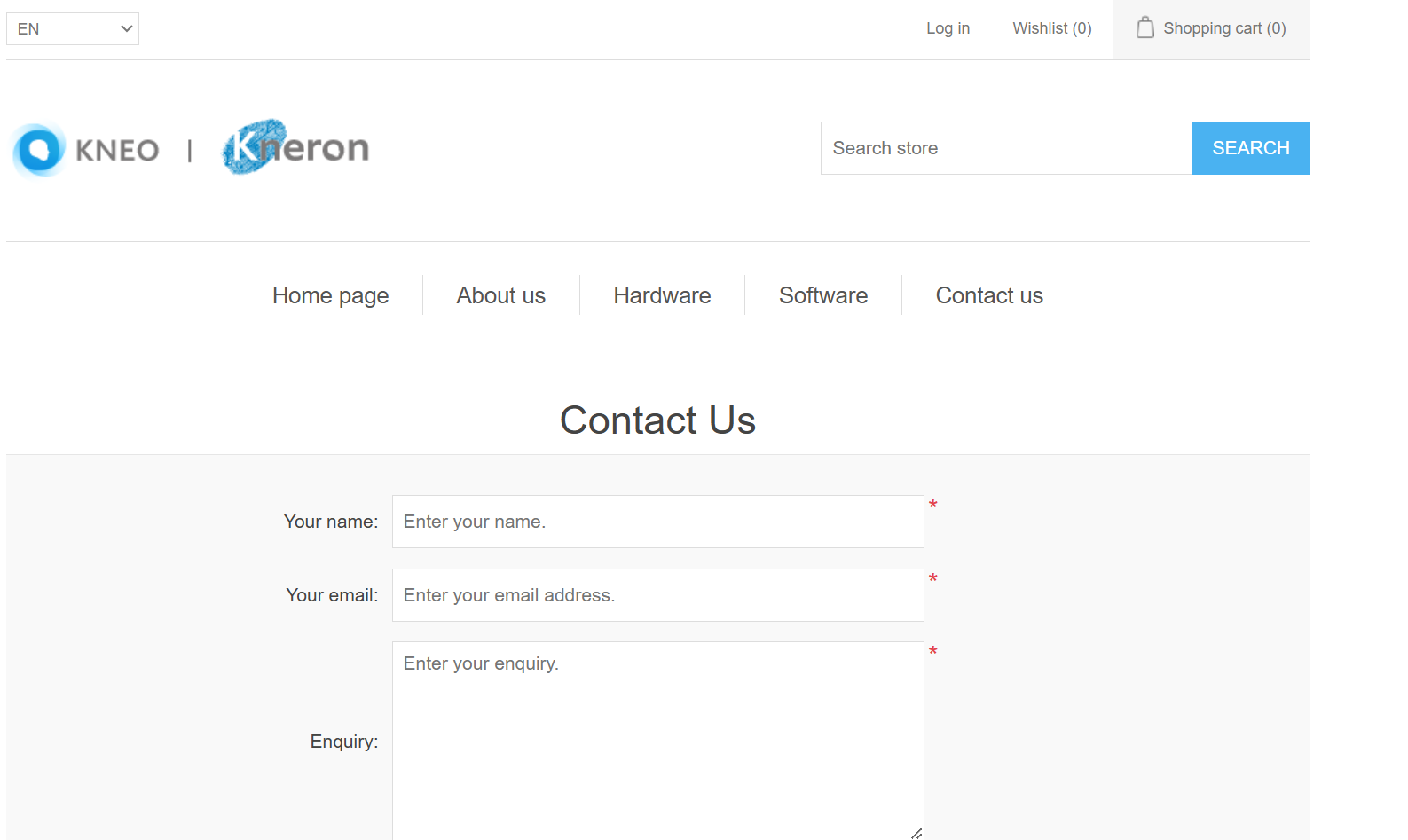

Hi Maria,
I've tried reaching out through Brian and the Contact us | Kneron – Full Stack Edge AI, but unfortunately, I haven’t received a response. Do you have another contact I could try? My issue is simple to resolve, but the lack of communication is delaying our production.
Thanks,
Hi Franklin,
I'm sorry for their lack of communication. Could you contact Jeffrey (jeffrey-yc.chen@kneron.us) instead and cc Brian just in case? Thank you!
