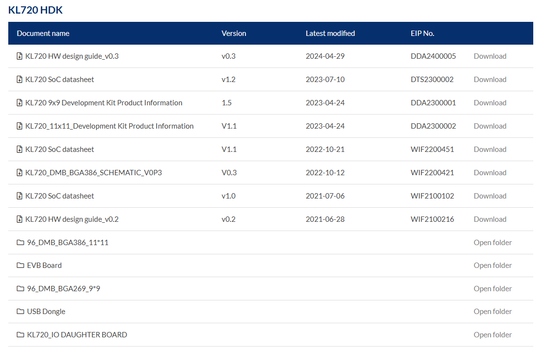

For a reference design for the chip, please contact our sales team. They would provide you a Kneron account with permissions, and you would be able to access the design documentation on our website, in the Development Center. Thank you for your interest!
Developer Center: Developers | Kneron – Full Stack Edge AI

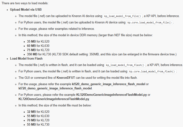

What I’m worried about is not really if it supports the operator, but the RAM size. It is the biggest deal for me.
What is the email of the sales team?
Hi Olivier,
The memory size restriction for KL720 is 70-75MB.
Reference: Write Model To Flash - Document Center
