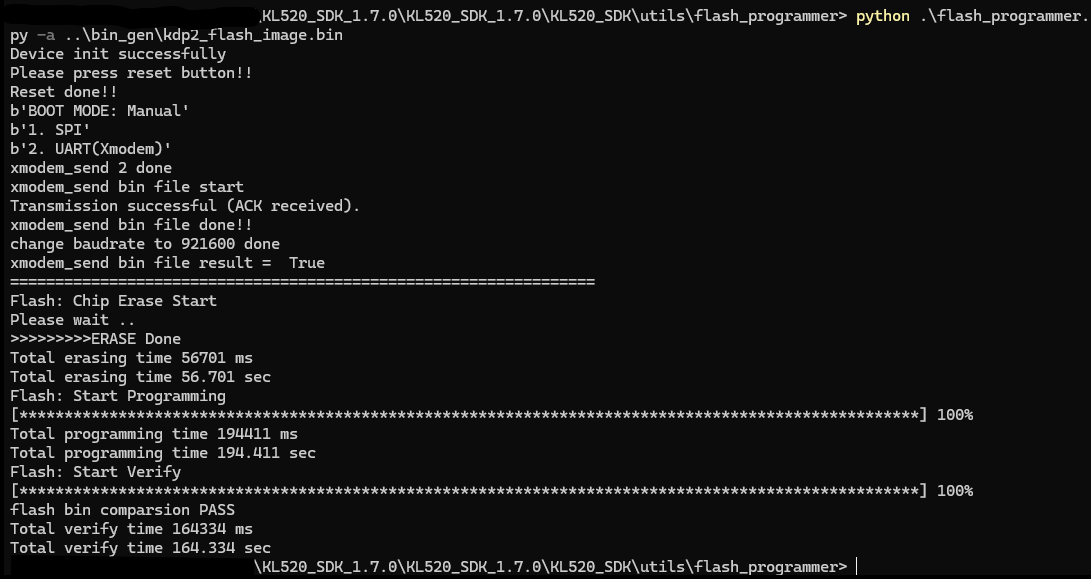

After flashing the image, I followed these steps:

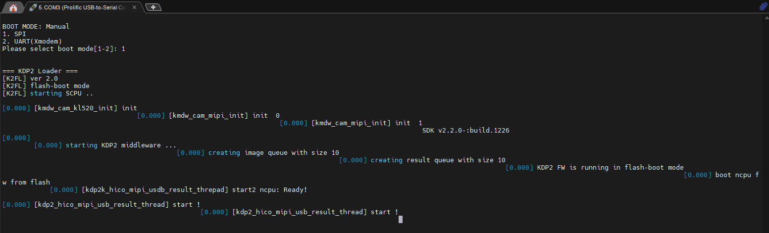

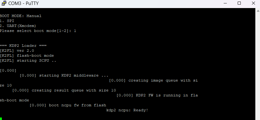

However, I always get stuck at step 3. The LCD does not display any image.
Here is the result I get (see below).
Can anyone help me figure out what's going wrong?

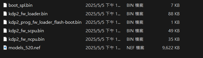

The bin_gin folder:

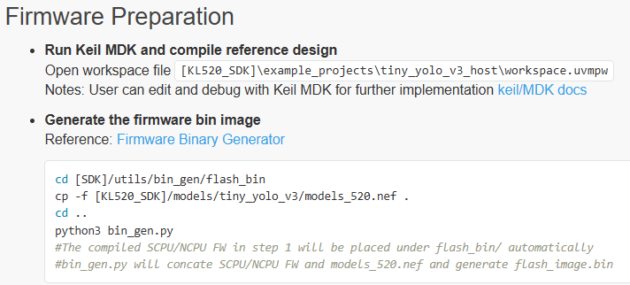

It seems like the flash_image.bin isn't the correct file, because kdp2_flash_image.bin seems to include KDP2 FW, which is used for Kneron PLUS. Have you tried generating the firmware by using the workspace inside tiny_yolo_v3_host?
Reference: Appendix - Document Center
Hi Maria,
I tried building
tiny_yolo_v3_host, and it is working now. Thank you!Hi,
