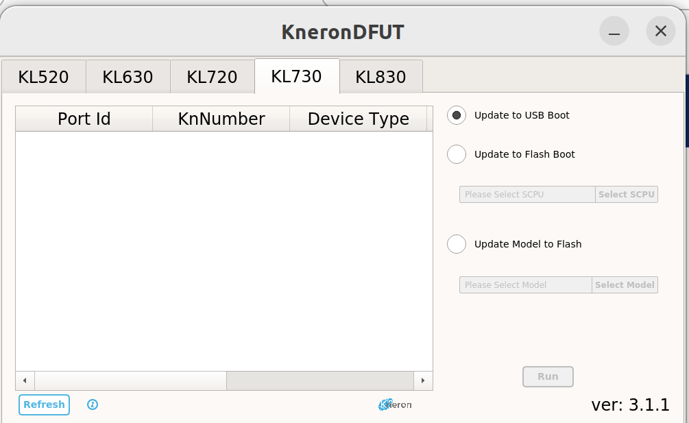

With all dependencies (https://doc.kneron.com/docs/#plus_python/introduction/install_dependency/) installed, when I enter script below, I cannot find any devices while USB connected to the board.
sudo sh KneronDFUT.sh

I could not find device using Zadig while USB connected with KL730 board.

  • Hi Dongkyun,
    What is showing up on your UART log? Please make sure that your KL730 firmware is the one used for Kneron PLUS.
    The file location is: SDK\04_Firmware\ubifs\fw_plus_nand_4k.ubifs
    As for flashing firmware, please refer to this documentation: KL730_Development_Environment_User_Guide.pdf
