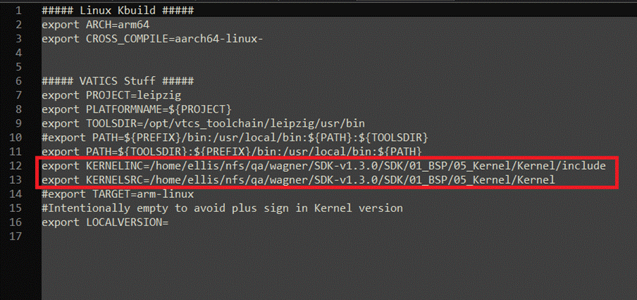

  • Hello,
    The "devel_leipzig" should be sourced every time you compile a file (U-Boot, TFA, etc.).
    e.g.
    If you are going to compile U-Boot, before entering the folder "/SDK_v1.3.0/SDK/01_BSP/04_U-Boot/U-Boot" to compile U-Boot, you must source the devel_leipzig with the command:
    source devel_leipzig
    (Depending on the directory of the file devel_leipzig, you should enter the path to devel_leipzig before running 'source'.")
    Then execute the steps to compile U-Boot.
    Don't forget to modify the parameters "KERNELINC" and "KERNELSRC" to match your environment.
    And remember, the "kernel" must be compiled before you compile any other firmware.
    So here are the steps you need to check:
    1. Modify the path of "KERNELINC" and "KERNELSRC".
    2. Compile the Kernel. (Don't forget to "source devel_leipzig")
    3. Compile other firmware. (Don't forget to "source devel_leipzig" every time before compiling)
