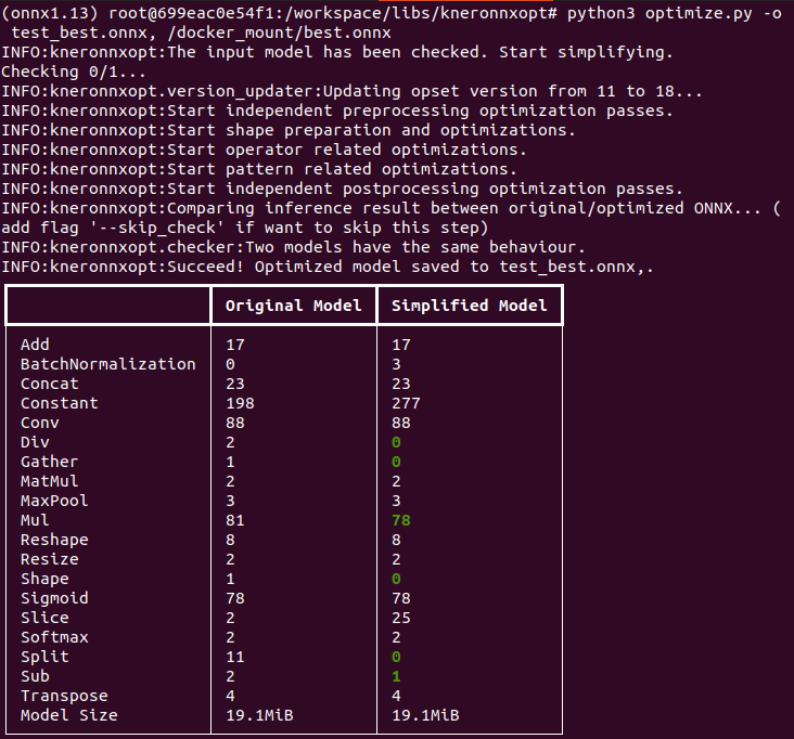

Thanks for the reply,
this is the output list of model operators after running optimize.py
after comparing with the resource you provided
I see all the operators except 'Constant' are on the list and supported on 730, have I got it right?
or are operators like Softmax still not supported on 730?
if there is a need for model modification, may I ask how can I modify it? does kneron support apis for modification
or should it be done using other resources?
The operator "Softmax" is supported on KL730, and you can check the compatibility of other operators using our support table: https://doc.kneron.com/docs/#toolchain/appendix/operators/
